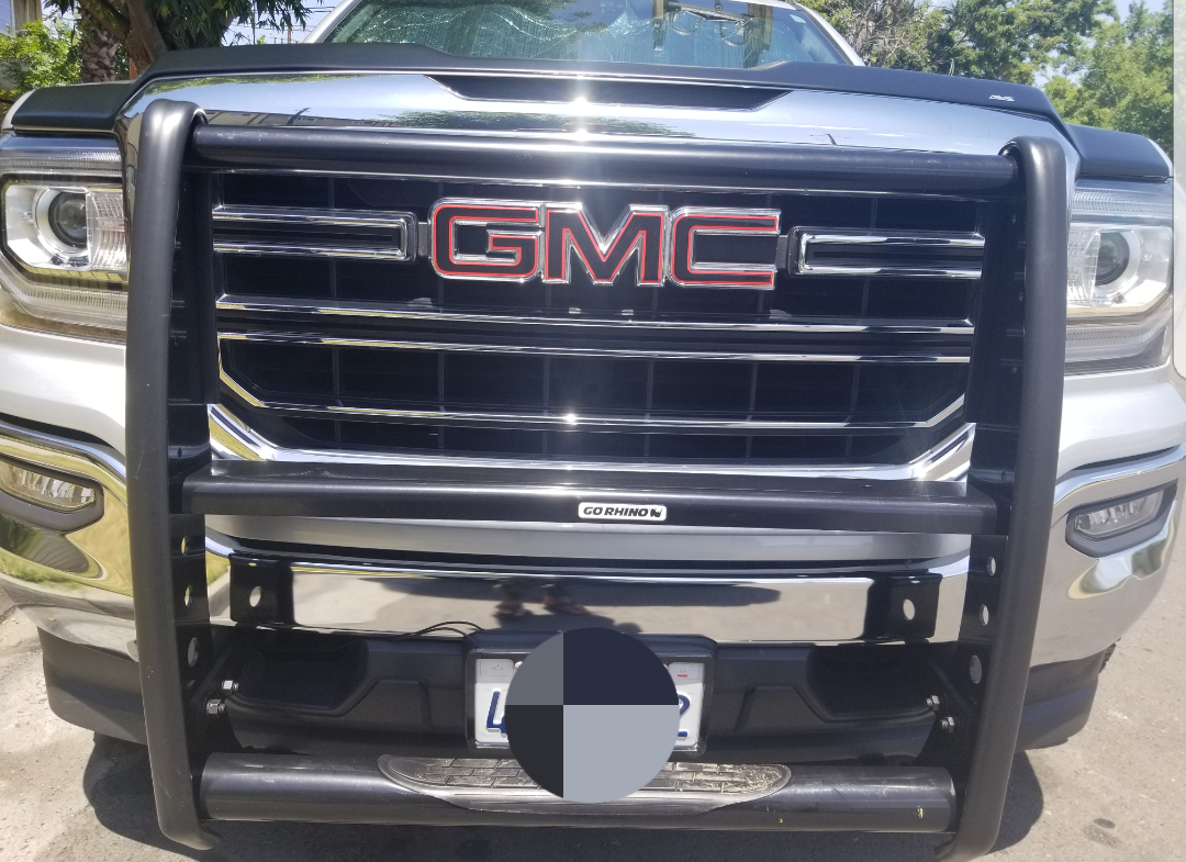

My personal input, I just got 4 cameras installed since my truck only had the rear camera and tbh, I rather have the 8" monitor used only for music and Google maps/Android Auto.
Initial thought for the front camera because parallel parking is a pain and not able to see if I'm going to hit a vehicle in front of me (again I have the lower end truck and it didn't come with proximity sensors like the high end trucks most of u guys own).
Now I have it, there are some cons. I have the license plate style...it just sits way too low. You can pivot up another 5 or 10° but it's not the way to go. The camera should sit below the M of GMC, or have a lifted truck to abate the height difference.  Also at this height at night you just see the glare of rear lights of vehicles.
The rear license plate height is just Okay..I wish I had it sit a little higher.

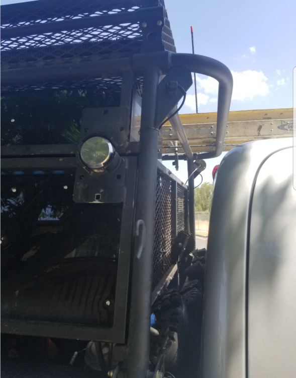

The sides are not typical but it's set up for my benefit.  Most of u have these on the mirrors.
I am still testing the cameras. It's on a trial run..the rear view monitor has passed my test..the cameras I am definitely switching out in a week. Going to see how it holds up

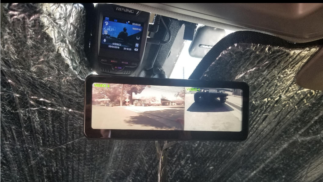

Here is the list of what I purchased. I can tell u how I feel about these items.
Master Tailgaters Frameless Rear... https://www.amazon.com/dp/B07D8J14WB?ref=ppx_pop_mob_ap_share
I originally wanted the Master Tailgaters rear view mirror with the Onstar button but they didn't have any in stock on Amazon so I went with this rear view monitor BUT I lost the Onstar button. That is one of the cons of this mirror. I like the fact I can have 2 views at the same time. Video quality is dependent of the cameras. For what it is, it does look OEM. Good quality.
Master Tailgaters License Plate... https://www.amazon.com/dp/B07DLFTMT2?ref=ppx_pop_mob_ap_share
Camera view should be as the same as our 8" monitor in REAR.
What a POS. I bought 2, for front and rear.  Camera sits too low for our trucks. I had to modify it and I remount it to my Go Rhino step guard. See pic. It now sits just as high as the one in the rear of truck. View quality is just horrible to view during the day and night. It's not comparable the 8" screen. I'm assuming any license plate cameras around the same price range (~$30) are of the same quality.
Reverse Camera,Front,Side View... https://www.amazon.com/dp/B074P17ZLF?ref=ppx_pop_mob_ap_share
For a cheap a$$ camera I'm really surprised. I already took truck at a car wash and I did spray hard  right at it..i also own a professional  steam pressure washer as well and shot 100° C water straight at it..still works fine.  Lens are rotatable (Be careful not twist outer cap from shell threads or it will break). For $17, let's see how well it holds up..
Video 1 and 4 are the Master Tailgaters license plate frame cameras. Video 2 and 3 are the sides.

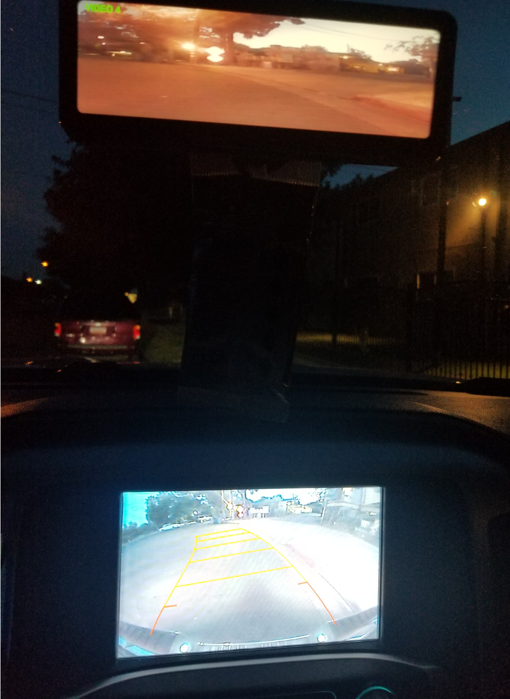

I just got back around tonight just testing the difference of front video camera quality now that it sits higher than before.  It looks better now that it sits higher. I am assuming interference light coming from the headlights. The rear camera looks the same, blurry. But now that I am thinking, it's prolly because light interference from the LED license plate light.
The side cameras I have since moved to positions where they get cover from the top so that is probably a reason why the view quality seems better.
Tomorrow morning I will fabricate a "helmet" for the front and rear cameras hopefully solving that issue. If it doesn't work going back to Amazon and checking out other cameras.
