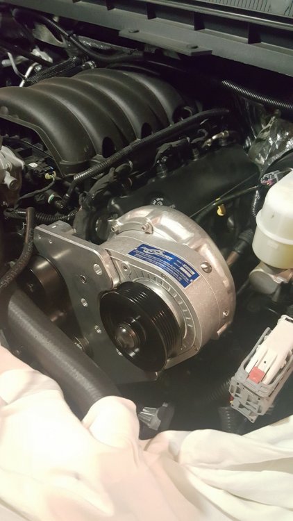

Well to 3 trys to get the supercharger to finally line up and clear the sub bracket, ended up clocking it about 1.5 inches clockwise, that thing gets heavy after awhile lol. Taking it back out to install the drain line but it fits properly now.  That'll be it for the day for me if I can get other pictures to load up I'll post them.

Plugs are done oil is done and the supercharger is in and not coming back out this time. Main harness is nicely tucked underneath and not touching and the brake booster line is good to go also added loom to that just to be safe it does touch the sub bracket.82676887854b52157d2ef83dd9e70e41.jpg352c17c52e18d613dd2a7f15b480f225.jpg

Well it's all done except the catch can waiting for Elite to respond to a question about vacuum line, 2 days I figured I would have heard by now so I temporarily hooked it up per Prochargers instructions. ECU will be back tomorrow so I can fire it up. I'll take a finished photo later still putting few things back together I will say the hardest parts for me at least were 1. Removing radiator shroud, 2. Hooking up the tubing, 3. That stupid air filter not sure why it can't be smaller, 4. Reinstalling the radiator shroud, 5. Getting the factory oil filter off I'm guessing the Hulk put it on, 6. Removing the last plug on passenger side and installing a new one. Hopefully tomorrow it starts up with no issues my only concern is the drive belt below the thermostat housing and hose it seems real close not touching but very close they should make a spacer for it to raise the housing a little be a good idea. a2ea5dbc727f479ce94250a2a3df784a.jpg7f7a22f45ab60022e48a3079fa2e56c4.jpg97d835277ca374e937ed91119134cd02.jpg

Here's the final pictures. Started up no issues idled funny for about 5 seconds been fine since. Thanks for following along. Took it for a little drive brought it home checked it out for leaks check all connections went back out pushed it to 4000ish just to feel it you can tell it's there I will keep an eye on it slowly work up to some wide open runs. Only thing I wish was the intercooler was black. Not sure what the standard gears sound like in person I've heard some on YouTube but helical gears are a must if these make it quieter I wouldn't want it louder. It's not annoying it's there you can hear it it's more of a whistle sound but any louder would be kinda much I think but that's my opinion only of course. bd155685ebb163dee063df21f5c1c4b1.jpg7e7f369d6f37e2173d9ec29f37934a39.jpg417a7c553a948b3e5548663bd3467fea.jpg04e12003c0e8dacc28691253a5d43e3b.jpg
