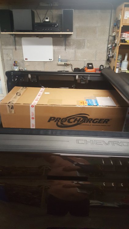

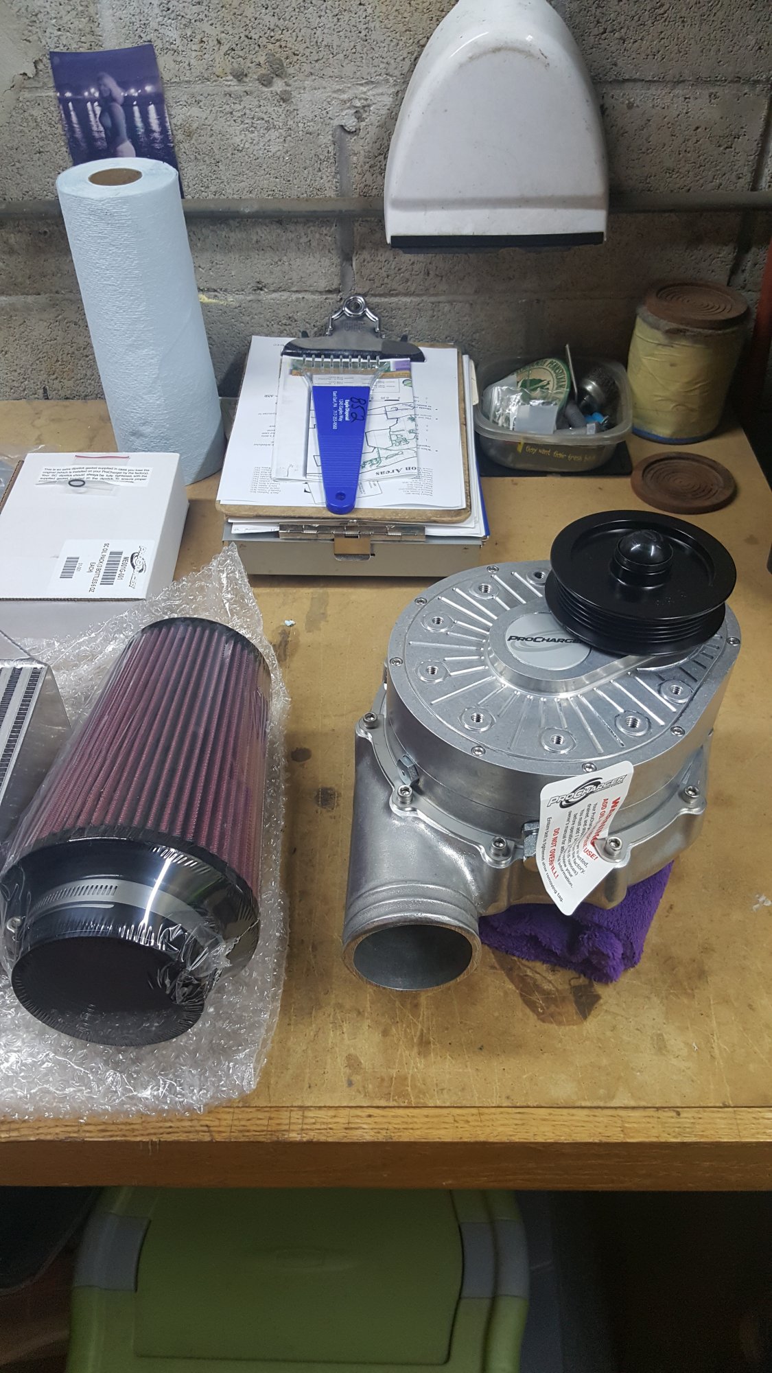

Well got the giant box open and after getting rid of the amazing amount of packaging (not a bad thing just a lot of it)  I figured you guys would like to know what is in the box.  The only things not pictured are the instruction booklet which by the way is very detailed color pages very easy to follow,  the modified radiator shroud that was a plus instead of having to cut the oem, and the package of stickers and licence plate frame.
Well that's the only picture you guys/girls are getting.  Apparently taking a picture of even 1 piece of tubing is to big of a file for te website 4.88mb is max allowed (lol) so sorry I tried but you get 7 packages of tubing rigid and rubber, the main bracket and sub bracket including spacers and hardware, the oil plus a 3 pack of extra oil, the intercooler that ways a ton btw, new ECU bracket, and the 2 things in picture above.  Sorry can't include other pictures I'll try to find a way to shrink the size.

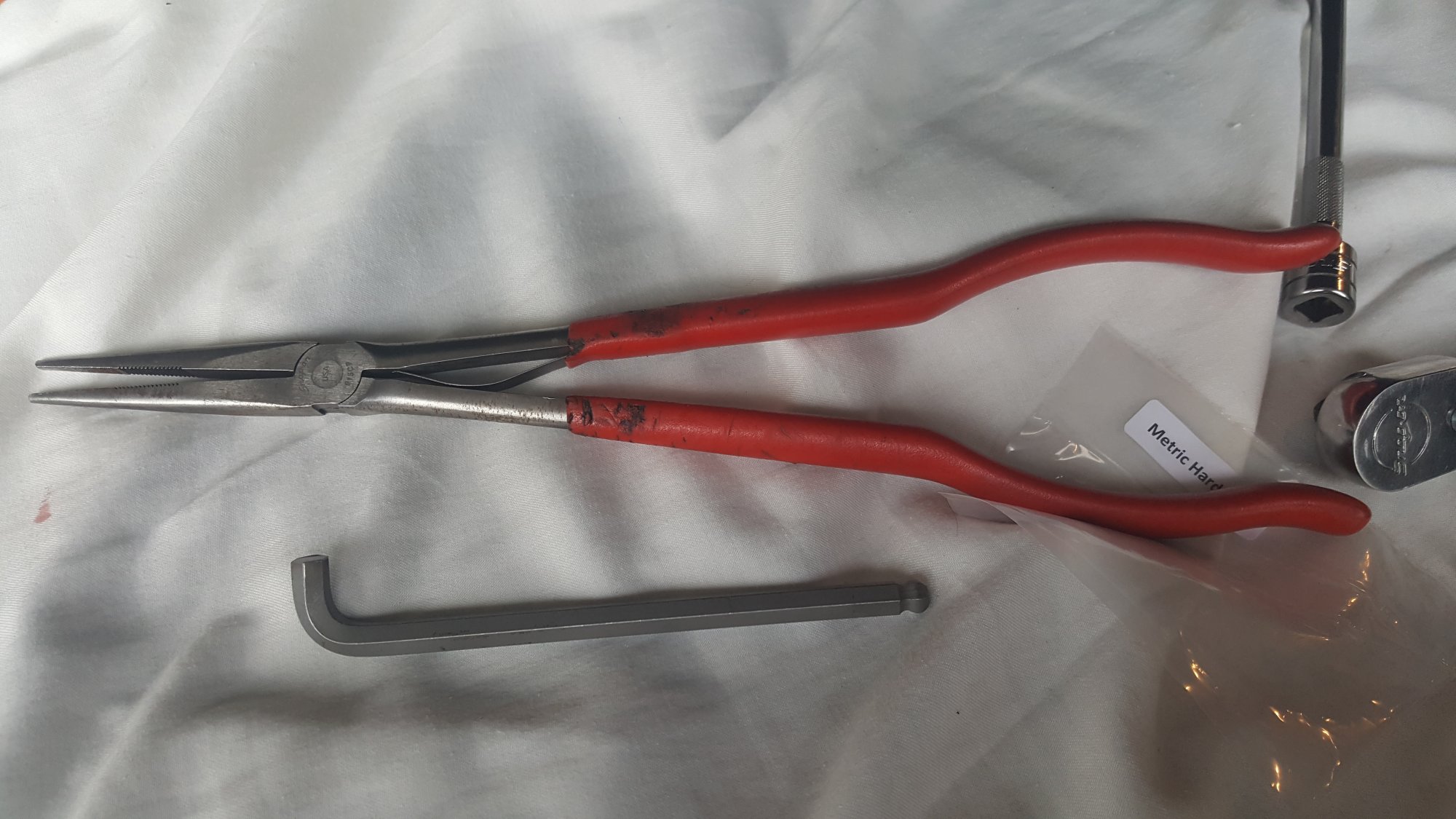

Got the sub bracket installed,  main bracket attaches to this part.  Anyone considering this kit I'll tell you now you need to be a little creative getting the 2 lower bolts in. I used very long needle nose to hold bolts and get them in.  Also need short Allen key only about 1.5 inches between bolts and water pump
