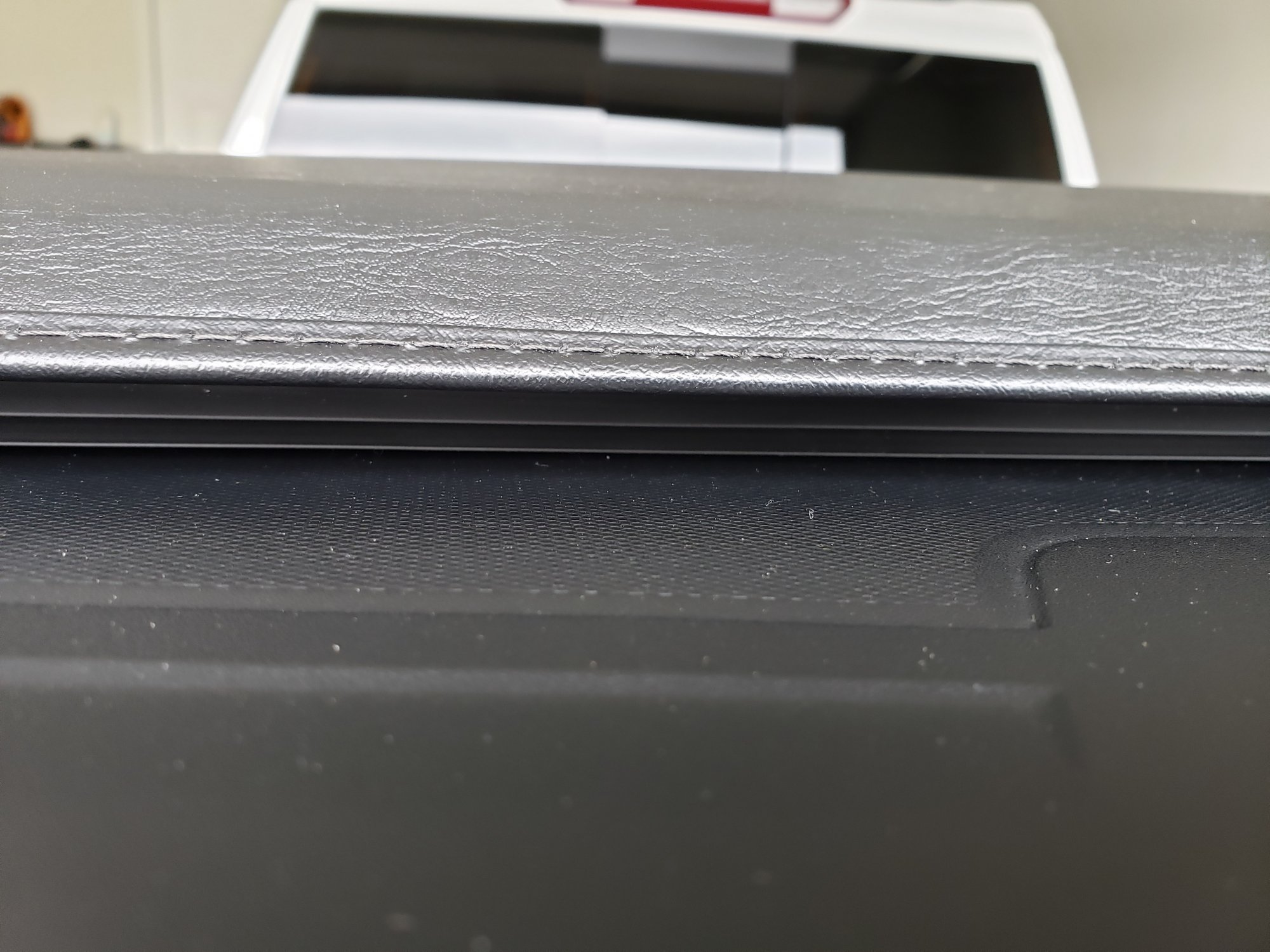

GM soft tri fold.  Works great now- didn't at dealership.  The seal on the back has rins that from the factory point to the cab.  Not good ad that stops the gravity drop these gates require. I removed the seal and turned it so the ribs face the tailgate and bingo, drops everytime unless the nose it pointed down hill.
Here is the rib I was talking about.

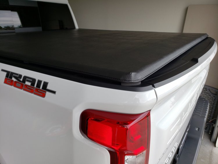

I made sure it was squared and just barely against the tailgate, and then compressed the foam by cycling the tailgate a few times.  That was the only part that was sticking at first, the actual install was fine and sqaure.  I am very happy with the tonneau.

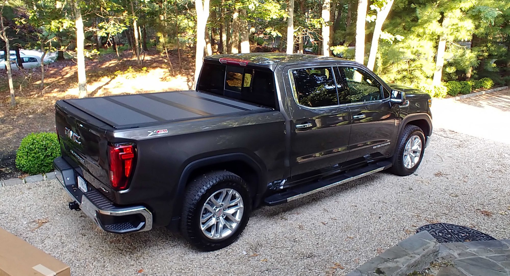

I have the BAK Flip 4 on my 2019 Sierra SLT Short Box with the Pro Tailgate .... it works just fine with one minor exception.
I had to pull it toward the tailgate to get the seal to meet the top of the gate.
When I did that the top section of the gate would not auto drop with the push button unless I gave it a little manual assist.
If I push the second button or the remote, the entire gate drops no problem with no manual assistance.
