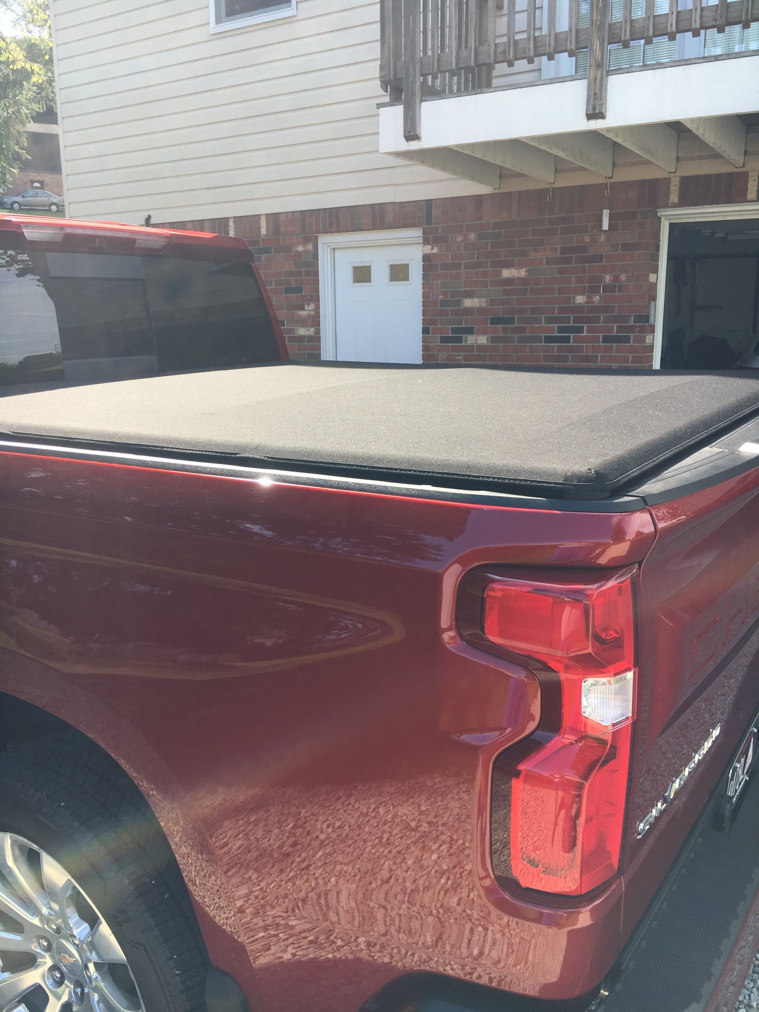

Looked like on the instructions to line the tail gate with  piece of foam and I thought "that tail gate won't open with the pressure on it like that" so I just left it off and started thinking of something to replace it with and trimmed down a garage door rubber piece. Maybe I didn't have to ha. She's water tight though and looks nice.
Oh, definitely not necessary to put anything on the tailgate. The seal on the cover mates against the back of the gate and nothing more is needed, I never have had any leaks. The two rolls of foam they give you are for the front of the bed. Two sizes, a short one for if you have the drop in bedliner and a taller one if you don’t. Think I used the shorter one even without the plastic bedliner because the other was way too tall.
Oh right on. I must of read the paper wrong. I had a 1/16" space on mine so I figured I'd seal er off anyways.

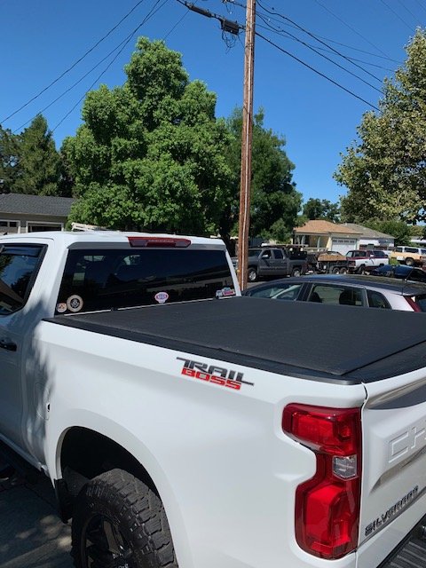

I have a undercover tri fold and mine works fine after I adjusted it
+1, I have an undercover ultraflex.  It stuck for a while, after a little adjustment and just using the tailgate more the power tailgate now works fine.

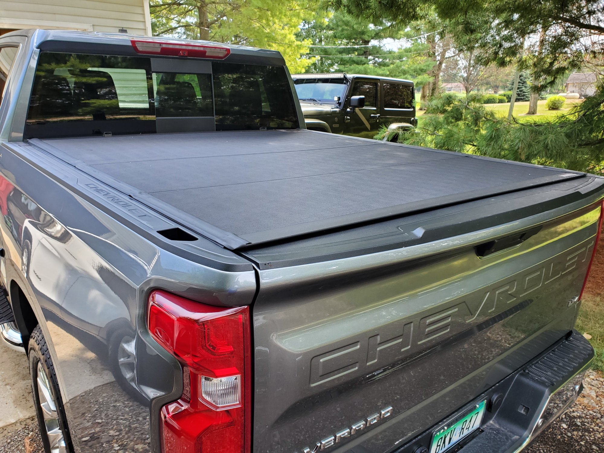

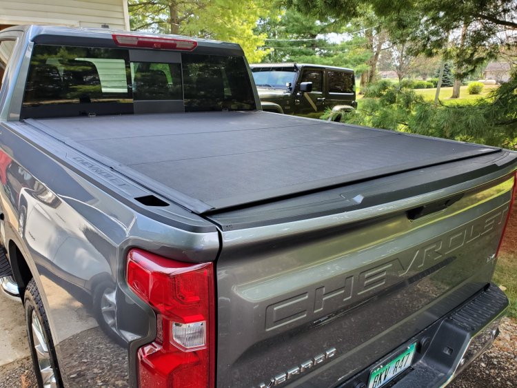

I recently installed Extang Xceed (replaced faulty Trifecta 2.0) and got it to work with the auto-down power tailgate....BUT i had to ensure the cover was pushed all the way forward to make it work.  If you follow the instructions in the box, it says to leave too small of a gap between the cover frame and tailgate lip; the extra pressure on the top of the tailgate in this config will prevent the tailgate from coming down without manual assist.
I also got and installed the same stake covers mentioned above from the eBay vendor.  Nice find Thunderstruck!!!
I also have the Extang Xceed and had to push it all the way forward to get the tailgate to come back up and lock.  Great bed cover.20190818_130231.thumb.jpg.1419c34f94672ffda62e2379d0e2b21c.jpg
