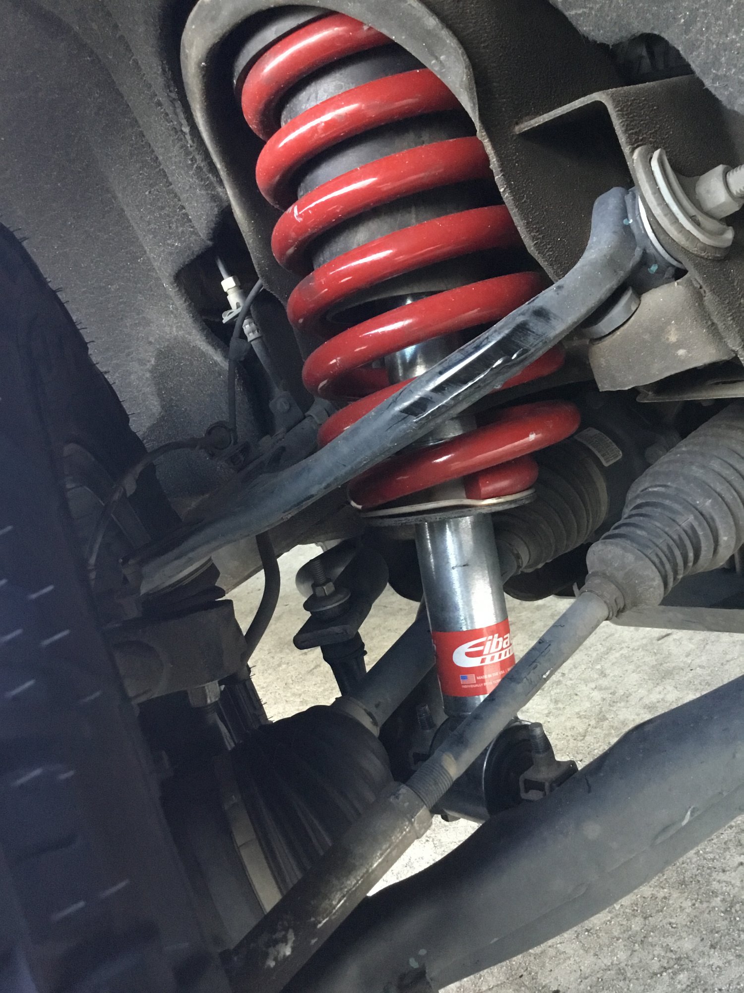

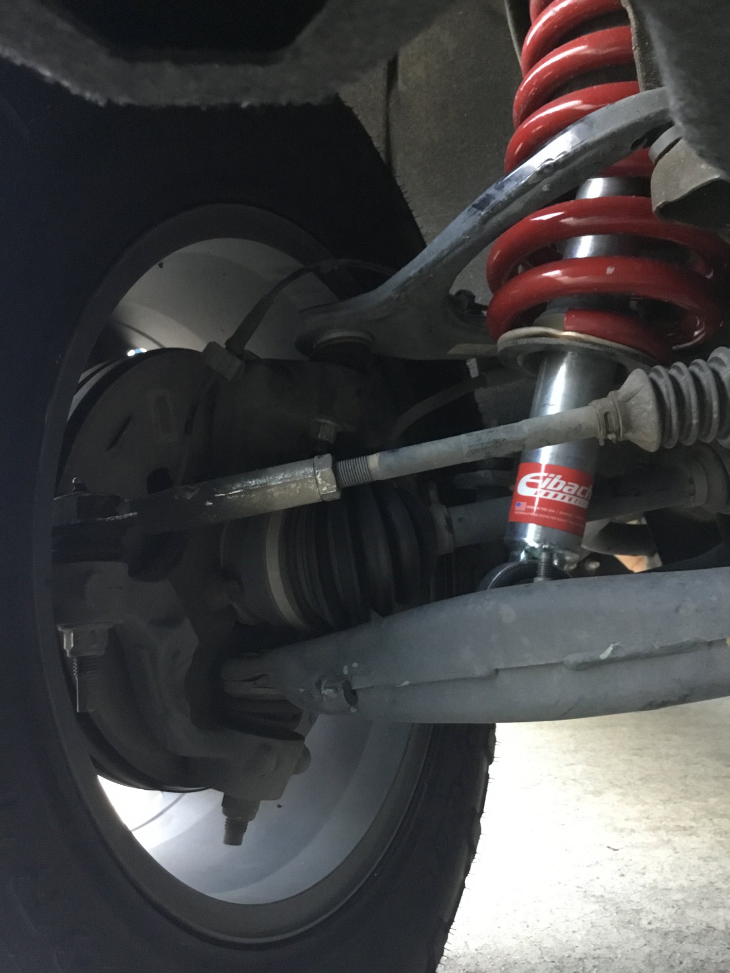

I just got mine installed Saturday.. didn’t change my uca’s but sure due look a bit wrong in that angle... Ill take one for the team and be the guinea pig on this one.....I don’t have much experience with owning trucks and how they feel but I guess I’m satisfied with it... I spent 565 for the kit (waited almost 3 months to receive them) 200 for install and 130 for alignment...kinda of a lot for just 2.5” but I’ve been working some good OT?

I went ahead and spray painted my springs as well.
I’m liking those red springs!

On 7/14/2019 at 12:23 AM, manderson7015 said:
Looks Good! How is the ride?
Man, I’m not to happy with the springs up front...looks cool in red and because they a thinker but really makes it hit  bumps rougher to stiff
