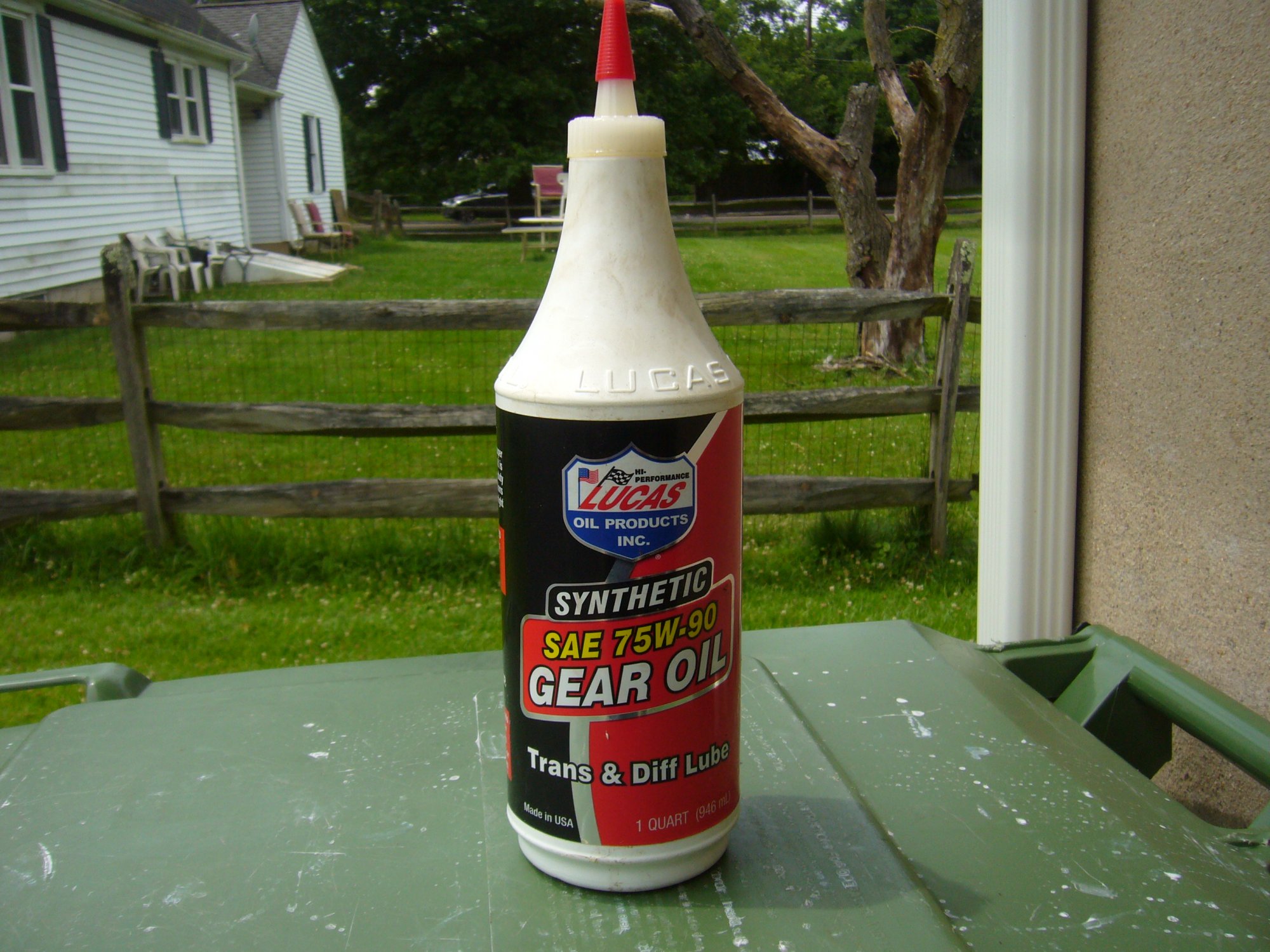

thanks for the input. it started to chatter before i changed the fluid. probably put like 5k on the new fluid with no chatter, than it started up again after about 60 mile drive down the turnpike to delaware at about 70 to 85 miles an hour.  i used lucas synthetic 75W-90. unfortunately i didn't do the first change till 75k, even had the trans fluid changed when i replaced the cooler lines .should have paid attention to my manual better. an expensive mistake!  again the chatter is not consistent but annoying when it happens.  there's a picture of the fluid i used. again thanks for the info!!
As others have said, the G80 is sensitive to having some friction modifiers, not too much and not too little.  It does have clutches that engage the locker.  Use either genuine GM grape juice, or I've been using Mobil 1 synthetic gear oil, 75-90 that says "LS" on it, for a long time without any issues.
Unless the Lucas specifically says it has friction modifiers for limited slip, then the G80 is definitely going to chatter.  Or they might be the wrong modifiers.  Stick with what's known to work well!!
