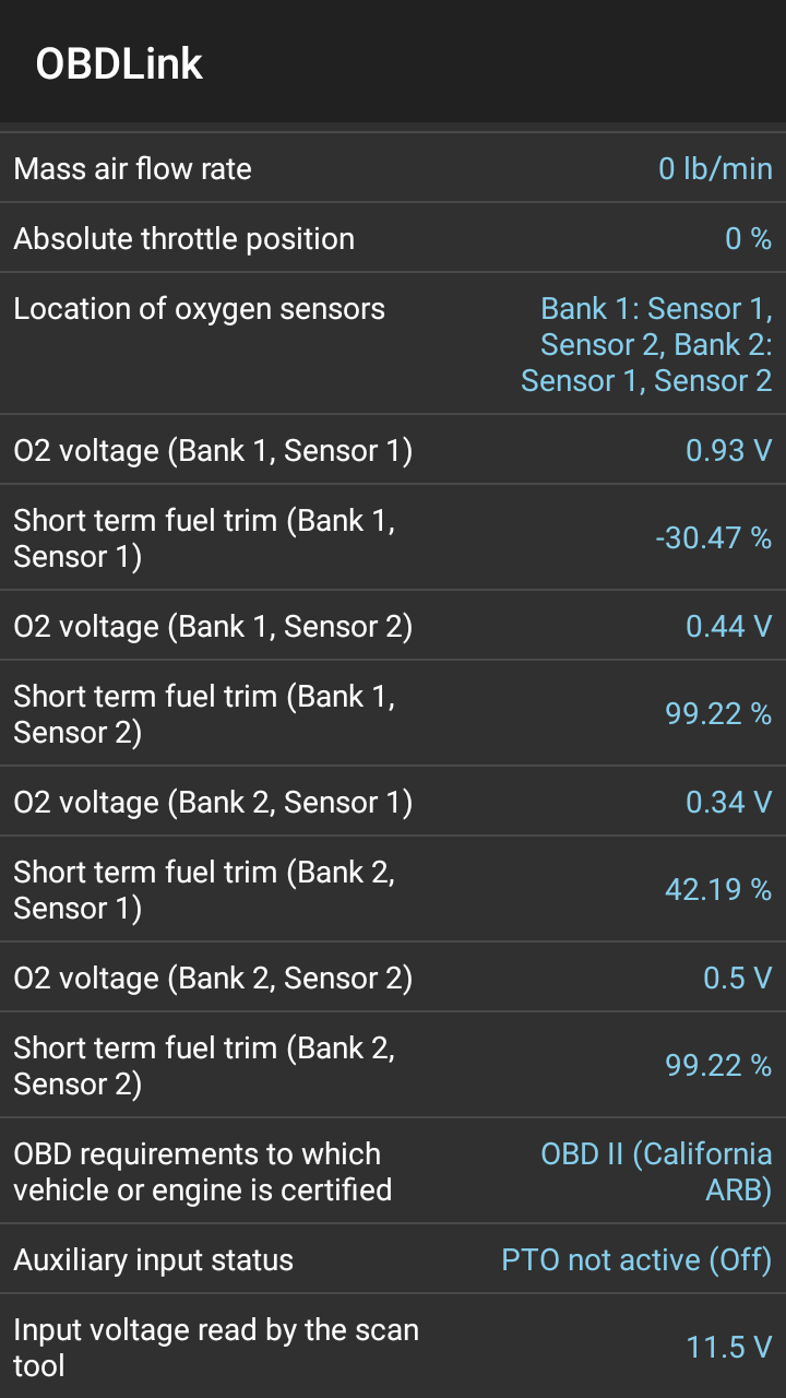

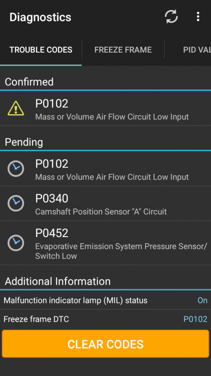

I finally got my OBDLink. Maf is reading constant 0 lb/min. Tried swapping mine with a friend's too. Supply voltage is 5v with engine off, ground is good. Not sure how to test signal wire - but is it safe to say it's the wire since we tried with my friend's MAF?
