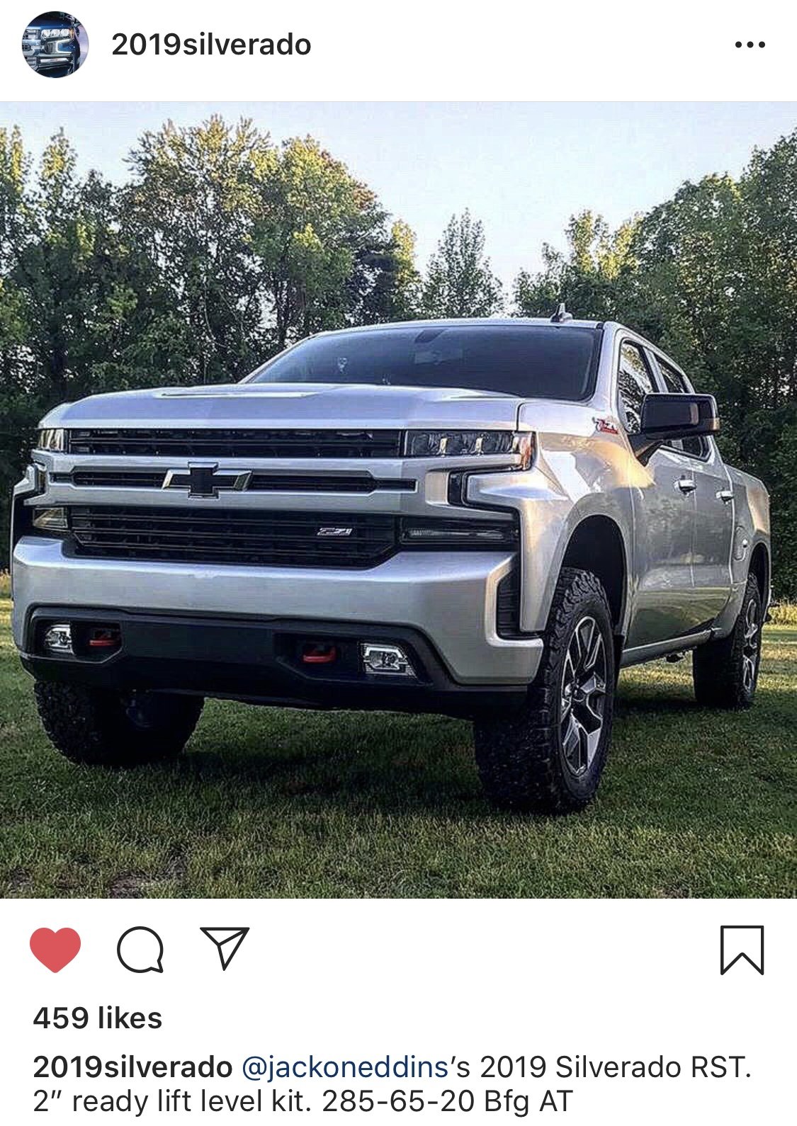

27 minutes ago, cal19 said:
Just came across this picture today. Not sure if they had to do any trimming though.
Man that’s beautiful that’s why I want to do it, but I really want to avoid trimming it.

why 24 ET? Go zero and get little poke.
Because the rims I’m purchasing which are OE creation rims have a 24. The one in the picture probably has 34

Worst case scenario, just remove the mud flap bracket like some of us have and it allows more clearance

That really is a GREAT looking RST.
This makes me want to get 285's for mine... ?

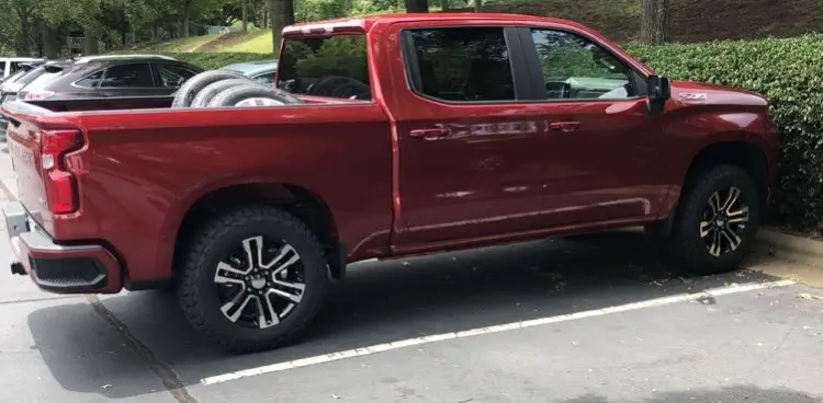

I have 285/65s on a stock wheels with no rubbing, every now and then when I reverse I hear it touch the mud flap but nothing enough to have made me trim it. I cant even see where it does touch it

I am looking to go this route but on the 18" wheels. The FB group has a member posted photo of a truck with 285/65/18s. They are running a 2" level kit with spacers to push the factory wheels out a little.
Is it the front that runs the mud flap when in reverse?
So is your truck about the same height as a stock trailboss like that? Or is the rear maybe an inch lower?
Judging by what I'm seeing here, is it safe to say that a 285/60/20 (33.5") would fit on stock wheels with a leveling kit?

285/65 20r (34.6”) Rims OE creation 182 +24 offset. Put a 2” ready lift leveling kit. I did not have to do any trimming, even kept the mud flaps, and there is not any rubbing so to answer your question you should be fine with plenty room to spare

Your truck looks great! What tires are you running? Thanks for the response.
