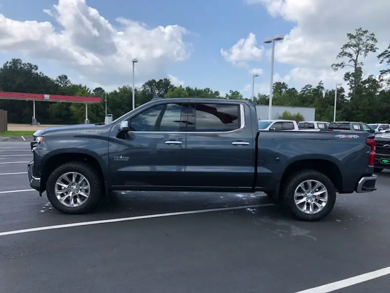

I've searched the forum and have been reading for a bit tonight about this and wondering if I'm missing something.  I'll make this as short as possible.  I'd like to lift my truck.  I've owned a lot of trucks, but only ever gone with leveling kits.  I want to put some 33" tires on for the more aggressive look and feel like I should move to a lift instead of just leveling this time.
We want to get a travel trailer, purchasing around January.  I'm aware the lift/bigger tires will hurt the towing ability slightly, which is one of the reasons I would stop at 33" tires, instead of 35".  I will also do air bags to level it out when towing.  Here's my main question, which I haven't really seen compared before.  I'm currently focused on two different lifts.

I don't think one will tow better than the other. They will tow pretty similar. The only thing that will affect your towing here is the front end being level with the rear so when your truck squats from the weight of your camper the front end will be sky high. Your air bags should help with that issue though.
When comparing lift vs lift however I would not put that Fabtech lift on. 3.5" is a lot of lift in the front of our trucks for just a spacer. Yes it has upper control arms designed for it so your upper ball joints will be ok but CV angle will probably be severe and it will probably ride like trash. The reason that BDS kit is more expensive is because the brackets that lower your differential so your axles don't grenade themselves as soon as you pull out the driveway.
I don't know how high you'd like to go but there are other brands besides BDS. BDS is probably the top brand though. Here is a kit from a reputable manufacturer http://zoneoffroad.com/zone-offroad-products-6in-suspension-lift-kit-chevy-gmc-pickup/c41n
This is great info. Thank you very much! I knew there had to be a good reason for the price difference. I’m thinking around 4” lift and 33”-34” tires should be good. I don’t want to go too big, for towing especially.
