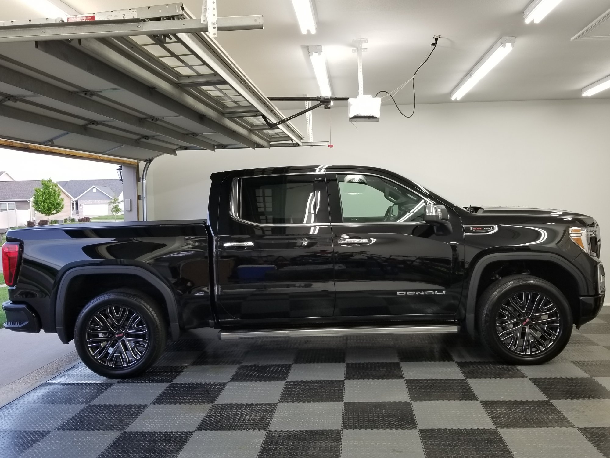

I installed the 2" Rough Country leveling kit on my 19 Sierra Denali and it still has a slight rake to the front end. Installation was a below spring mount and I felt no difference in the ride quality. Make sure you get the front end aligned after installing. I attached a picture below to show how the rake looks.
Note: When pulling a trailer it has a more squat look at the rear because of the increased height of the front end.

Looks really good! I see the motofab is like half of square shape/ U shaped and the rough country is circle/puck shape. Anyone know why that is or does it even matter?
It looks like Motofab offers both the U shaped and circle/puck options. Choosing between these two can depend on the height you are trying to achieve. The U shaped level spacers install under the lower shock and the circle/puck style installs on top of the strut. The circle/puck style spacers are normally to go above 2" or 2.5", but can still be used for a level below 2" if they are built for that application. Since you are only wanting 1-2" total leveling at the front you would only need to go the U shaped route unless you wanted to put in some extra effort and install the Motofab spacer at the top of the strut. Either would give you the same result. The U shaped route is easier because you only have to loosen the upper strut bolts opposed to removing them. Rough Country only offers the U shaped spacers, but Motofab looks to offer both options.
