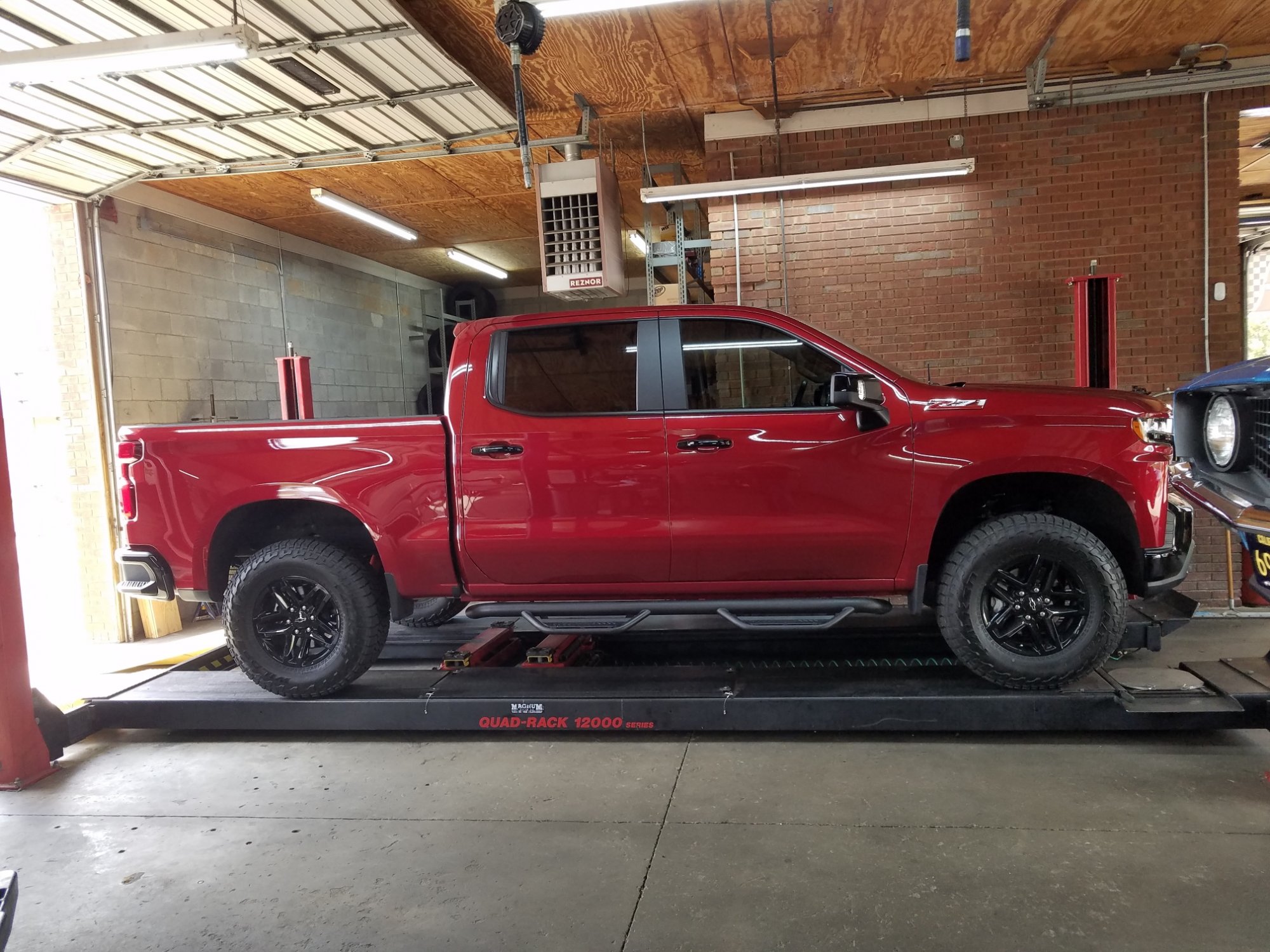

On 7/9/2019 at 8:07 PM, jkrunningdeer said:
Would you be willing to post a side picture of your truck. Thanks for sharing the motofab info. I'm trying to level and fit my truck in  the garage. the 1.5 might be just what I'm looking for!
Motofab 1.5” installed on mine... actually rides better now IMO
50 minutes ago, Thejet07 said:
How much did dealer charge you
About $350... 3 hours... included alignment
