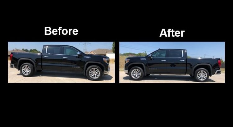

I just did a Motofab 1.5".  It was hell to get in on the first side, then I realized that there was a 3rd upper strut mount hidden back there with crap mounted to the stud that needed to be loosened to be able to move the strut around.  Once I did that, it was a breeze to install.  The other side took me 20 minutes.  Mine gave me just a hair over 1.5", call it 1 5/8".  I wanted a little rake, and that leaves me with just under 3/4".  I am very pleased, and glad I only did 1.5" because my alignment was still within spec on all measurements.  These pictures don't do it justice, this looks a ton better in person, zero noticeable ride difference.

AJ, are you saying you didn't have to wind up getting an alignment with the 1.5" kit? They threw it on the rack and it was in spec so they didn't have to adjust anything?

Yes.  All that I can think is that mine may have been a little off in one way, (I didn't check it before I installed the kit) and this one just moved it the other way, but still within spec.  This does not mean that you can get away with not checking it, or that yours will do the same.
Yes.  All that I can think is that mine may have been a little out of spec one way, and this one just moved it the other way, but still within spec.  This does not mean that you can get away with not checking it, or that yours will do the same.
Hear ya there. I will get mine checked regardless for sure. I have read some of the folks that installed the 2” level the truck wound up sitting nose high. I need to measure mine to see the difference between front and rear as it sits now, but thinking I’ll wind up with the 1.5” kit.
