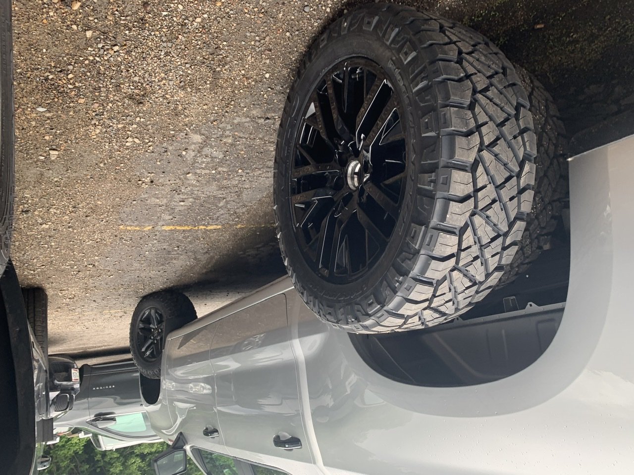

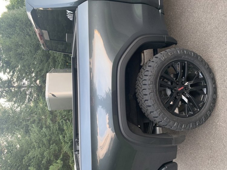

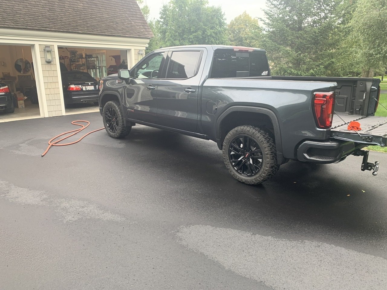

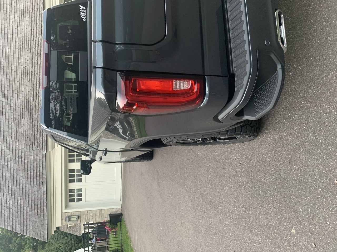

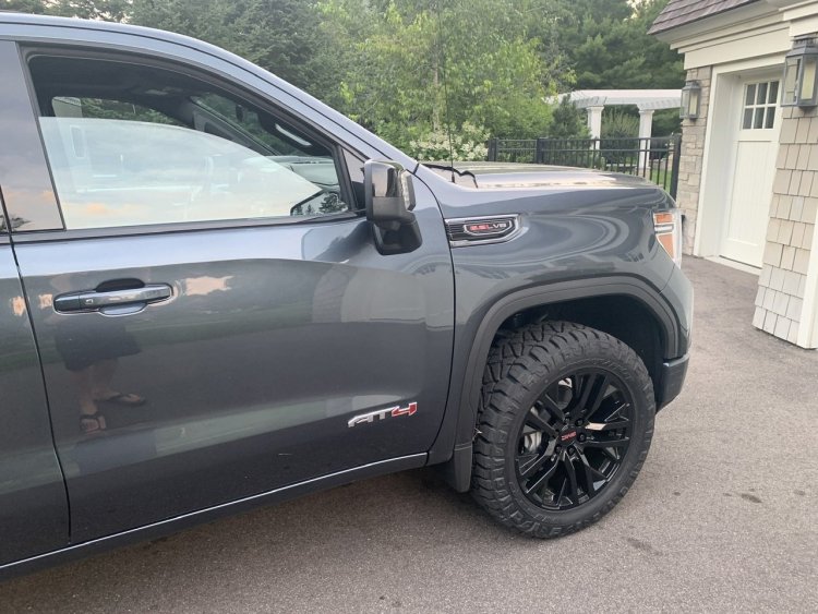

285/55/22 - 34.5 inches
oem 22x8.5
36psi
-flush with fenders
-ride is much improved, noise is down
-lost about 2mpg vs oem 20s
-no level kit, stock suspension, no rubbing
no regrets, love the setup
Towed a couple loads around 9,000lbs no isssues, rock solid
posting this on my iPhone, no idea why shits upside down

Hmmm...., Love the look, how is it on bumps on the road vs. the OEM 20's? I've run E rated tires before and have hated the ride, very concerned about losing ride quality, but I sure like the look.

The ride was improved in all aspects. Highway joints, transitions, potholes are really just soaked in now.
Around town and at slower speeds it feels great.. steering isn’t strained or affected.
I see a lot of folks running these massively wide tire setups which dramatically affect the ride and handling properties of these trucks.
I found that the 285 is the ideal width that still looks beefy, is perfectly flush with the sidewalk, and properly fits the rim.. it tracks perfectly on the highway, doesn’t pull or “follow” in road depressions from heavy semi use.
I ran psi numbers from 32 to 46 and I found that 36-37 was indeed the sweet spot for these tires.
Tires are a good $450 each but this is something you don’t cut corners on. Spent 4 months testing and dialing in this setup and it’s a 9.5/10.
Only con was the slight decrease in MPG.
I was also not able to tell any negative “performance” related effects from the added rotational mass... and I’m crazy about that.
Forget E-rated.. all that means is that the tire has the capability to run a higher PSI.
The make/model/design/engineering on the actual tire and the actual psi you run are what’s critical.
This tire was design to look meaty and ride nice on the road. It does that very well.
