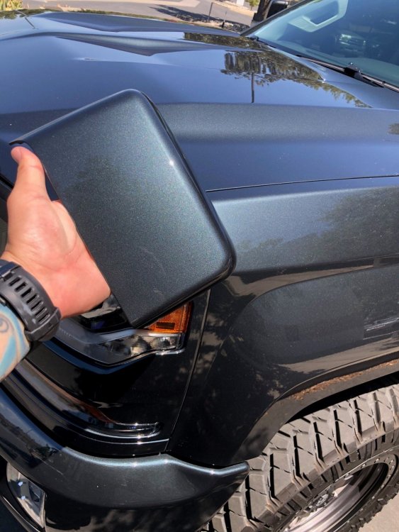

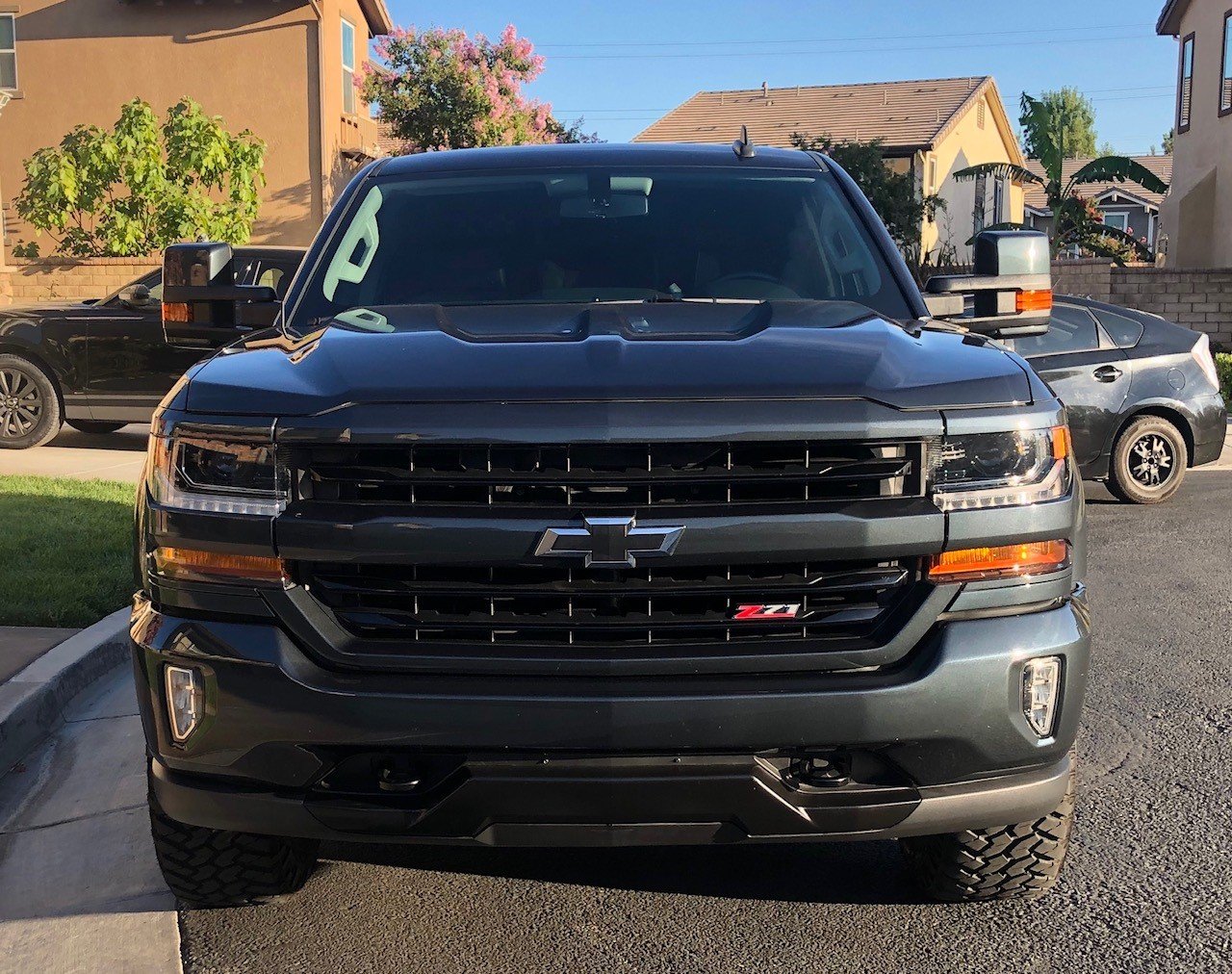

I just installed Boost Auto paintable tow mirror caps.  I went to my local body shop and they wanted $350, I thought that was a little pricey.  I watched a videos on how to paint them myself.  I ordered my paint kit from touchup direct, you put in your paint code, make, year, and model.  I think the kit was $60 and that includes primer, color, and gloss.  It actually came out really good.
Your caps look man! I thought about doing them myself but man i so add id screw something up. Im jealous!

Thanks!  It's actually a super easy process.
Sand the cap to scuff them up
2 coats of primer
Wet sand them
2 coats of color
2 coats of clear, let them sit of 24 hrs
wet sanded them with 3000 grit and polished them out.
