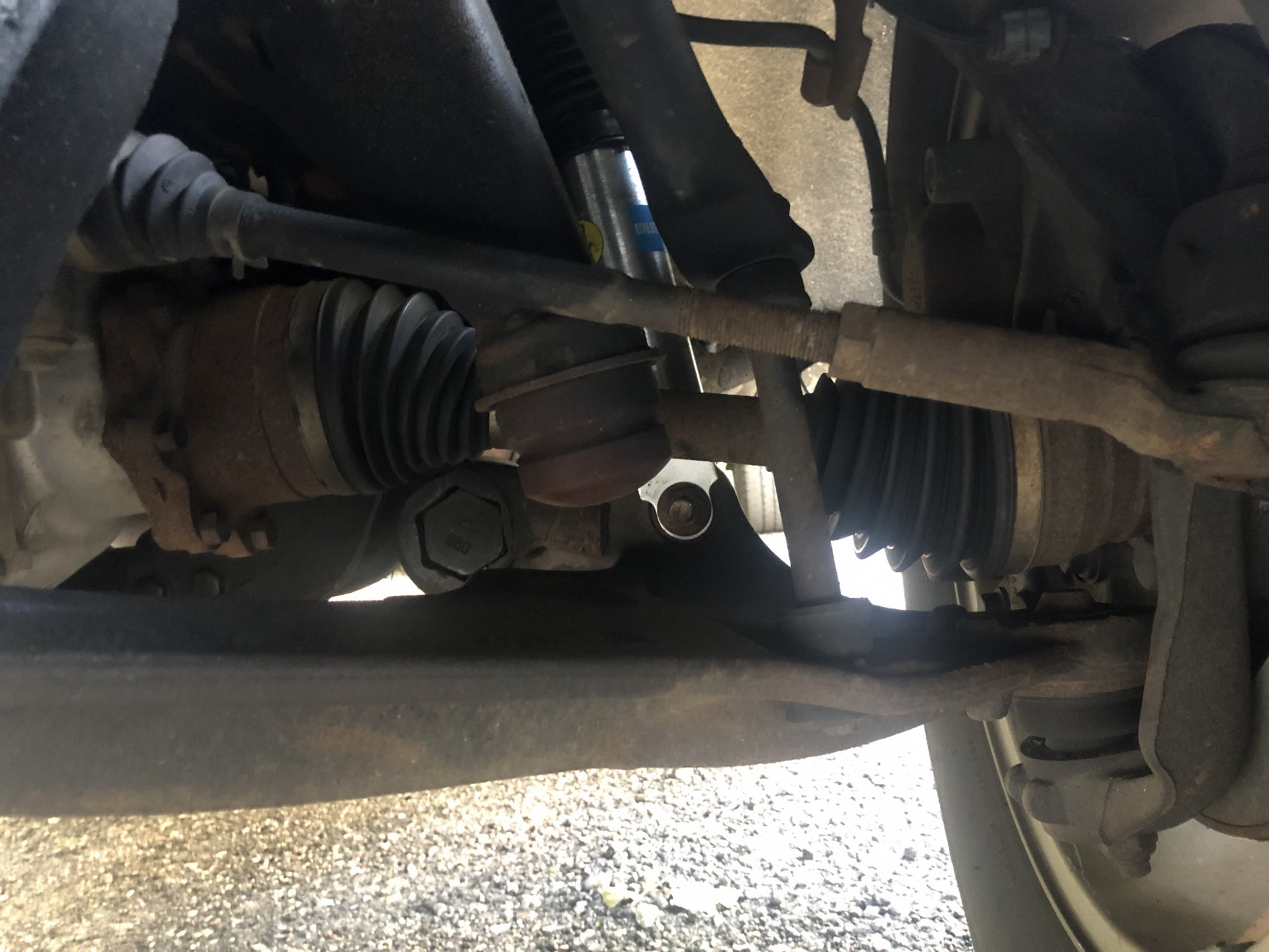

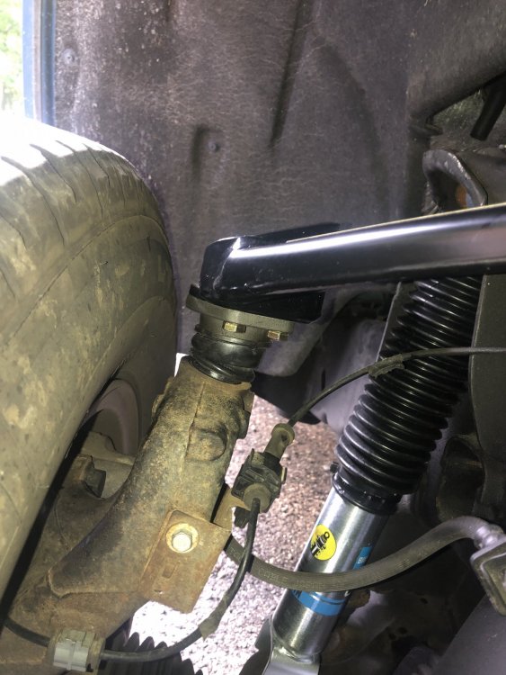

Just thought Id share some pics of my CV angles and ball joint angles after kryptonite upper control arms and diff spacers.  What do you guys think? Too much angle?

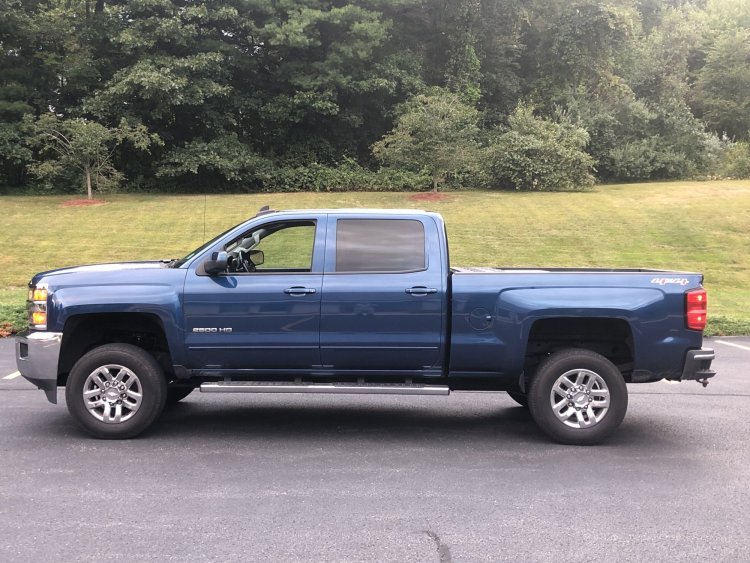

How much lift?
Pic of truck with lift?
Ideally, CV shafts should be as close to level as possible. Yours are not ideal but not horrible either. Maybe email cognito and ask them about the angles?

Kryptonite stage 3 kit, leveled the front maybe 2".
What you're looking for is if the boot touches itself because of the angle.  That will wear the boot out and let water/debris in.
The upper control arm, correct me if I'm wrong, only changes the clearance of the UCA and bump stop...To fix your CV angles, which I think look fine, you need differential drop spacers.

You and I are running similar set ups. My angles are just a little less, I’m running a diff drop, upper control arm angle looks fine.

I bought my diff drop and shock spacers off eBay, Cheap, but well made, STD or something, have lasted 2 years.  No corrosion, powder coating still looks fresh, can’t complain. Ready Lift UCA’s, grease-able upper ball joints, some kind of special bushings that don’t squeak, and they don’t squeak at all. Aftermarket torsion keys, because my +12 offset wheels would rub cranked in a parking lot turn.  I like to wrench on my stuff, so easily installed the UCA’s in the garage, MUST get alignment afterwards. I’m also running a BDS steering stabilizer, and Cognito steering braces. The braces sucked to install.  The UCA’s where the last piece of the puzzle, and they freed up everything, the 5160 Bilsteins offer more travel, and the Ready Lift arms droop more, so I got a great ride going on this thing. With my bumper, winch, sliders, tools, and accessories, my truck weighs in at 8,300 lbs.
