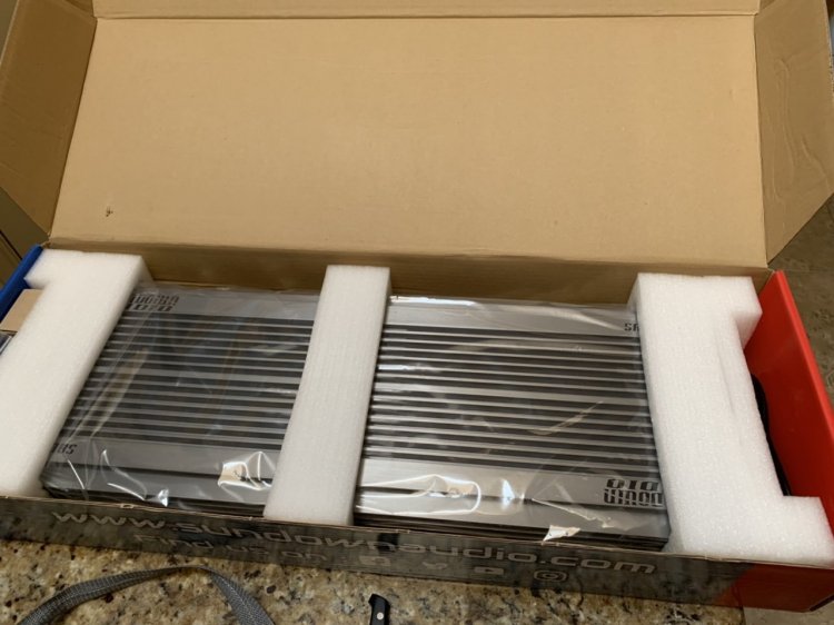

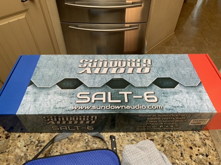

As of right now I am running Focal components in the front and Focal coaxials in the rear with two Focal flax 12's.  One Audio Control D4.800 and LC800.1.  Mids/highs amp is only using around 400 watts and the sub amp is putting out a little more than 800 watts.  So a little over 1200 watts at full tilt and voltage never moves from 13.9 at both amps.  I have an oldschool Cadence A7HC that makes really good power for a 20 year old amp.  I built an enclosure for two Sundown ZV5s for a guy recently, and tested it in briefly in my AT4.  Voltage was 13.8-13.9 at full tilt.  I did not clamp to see how much power it was putting out but I installed it in the other truck on a Salt4K, the Salt amp was definitely louder, but my old amp really surprised me.  This being said, I feel like we have pretty good stock electrical in these trucks.
If the 220 amp alternator would interchange, I think it could handle 3000 watts if a powerful AGM or Lithium was added.  I'm not saying the stock will handle the Salt6K by any means.  370-390 amp will definitely be needed for all of that gear.
