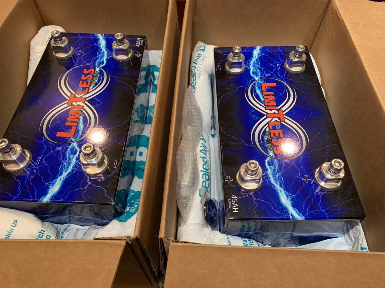

I also have two 45AH lithium batteries from Limitless lithium that have the same capacity of
18 50lb AGM batteries. Really a no brainer as I dont want to be lugging around 800-900 lbs of batteries as these lithiums only weigh like 36 lbs combined. They charge fast as hell too.
