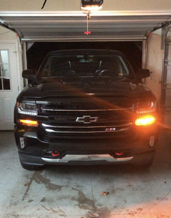

 I installed them last night and the initial quality seems to be good. Easy plug/play installation and no hyper flashing. MUCH brigher than stock. Can’t comment on longevity yet, but so far so good. Here’s a pic with the incandescent on the passenger side vs the led on the driver side..

They are extremely bright and work as described. They are 7440 bulbs but are fully functional being that there is only one function for the front turn signals on the K2XX. (Still not sure why it calls for 7443). Hard to tell in the picture due to the angle, but the left side is the new LED bulb. They are so much brighter than stock and give the turn signals that modern look. Worth the buy so far.
