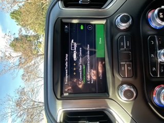

Problem is, with the camera plugged And the trailer plugged in, I get no video, just black screen in the trailer view. I also noticed when I switch to the view, the camera selection menu glitches out and movies up a half an inch on the screen. I attached a picture below. I Tested the camera on a 2020 and it connects, picture below of that as well.So I know the camera works.

I have a 2019 Sierra 1500 SLT with the trailering package. I purchased the trailer Camera from GM. The instructions seem to be plug and play, which is different from the 2020.
