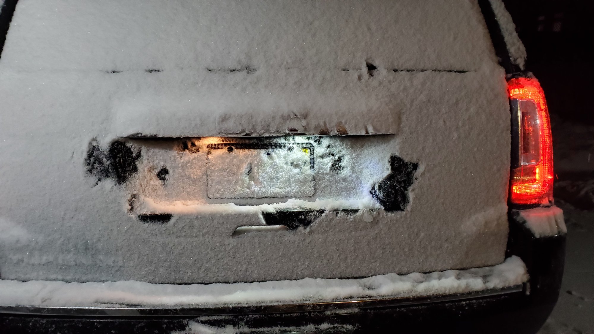

FYI, I got GTR Ultra LED in plate and reverse spots and boy what a difference in look/style as well as light output. Here's some pics for comparison:
