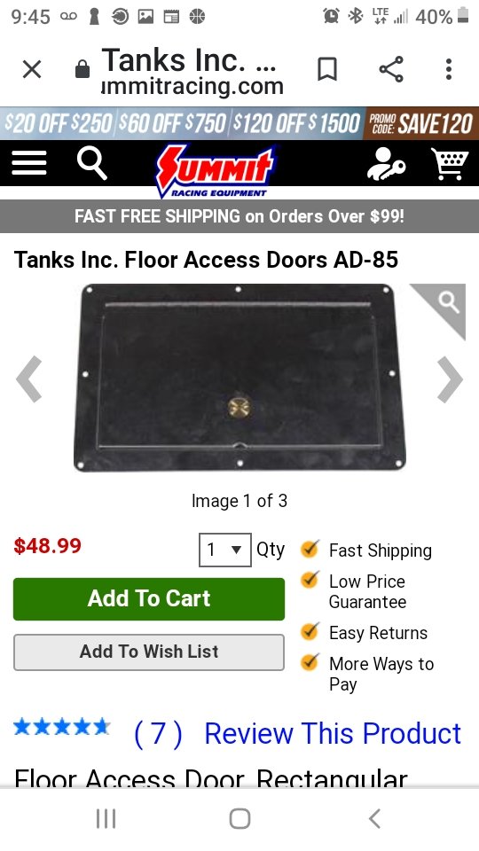

 I completely agree with everything everyone was saying about the fuel pumps. They are very finicky, I've had to replace my fuel pump so many times I got sick of dropping the tank. I took a grinder and cut a hole in my bed right above the fuel tank and you can buy a locking airtight door online for that specific reason. I'm sure a lot of people won't agree with cutting a hole in your bed but with the locking hatch you can buy online it looks very nice and I am very happy I did it. I can now change my fuel pump in about 10 minutes. I've only ran out of gas in my truck once and I did have to replace my fuel pump after doing that. I don't know if other people have the same problem going through so many fuel pumps but for me I was very happy I did it the last time I had to change my fuel pump. But from my experience of having so many fuel pump issues I would almost guarantee it is your fuel pump. But like others have said definitely change your inline fuel filter as well and when you're changing your fuel pump make sure you clean your tank and get rid of any debris in the tank. It doesn't take much 2 destroy your fuel pump. Just a idea in case you have many problems like I have had with fuel pumps. Screenshot_20191111-094537_Chrome.thumb.jpg.0be15691a1a510edfa85df353832a067.jpg
That's a nice idea.  How did you determine the location and where to cut?
