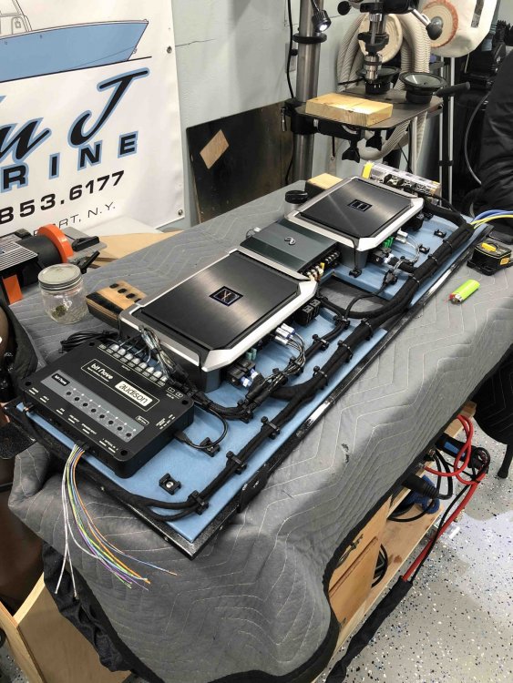

Front speakers: Focal PS165F
Rear Speakers Focal PC165F
DSP: Audison Bit Nove
Highs amp (front mid and tweeter active):  Alpine X-A70F
Rear speakers: Infinity Primus 6002A
Bass: Alpine X-A90M

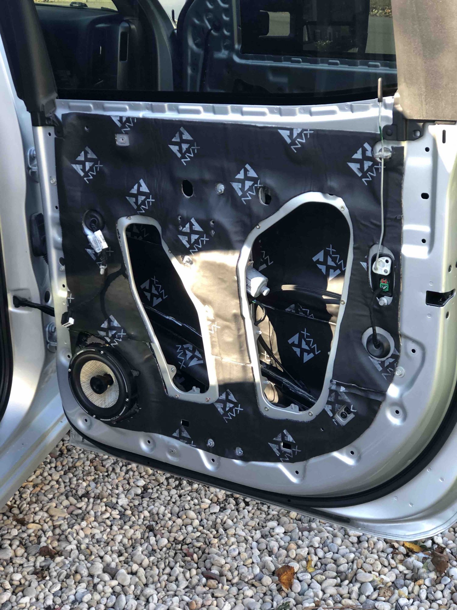

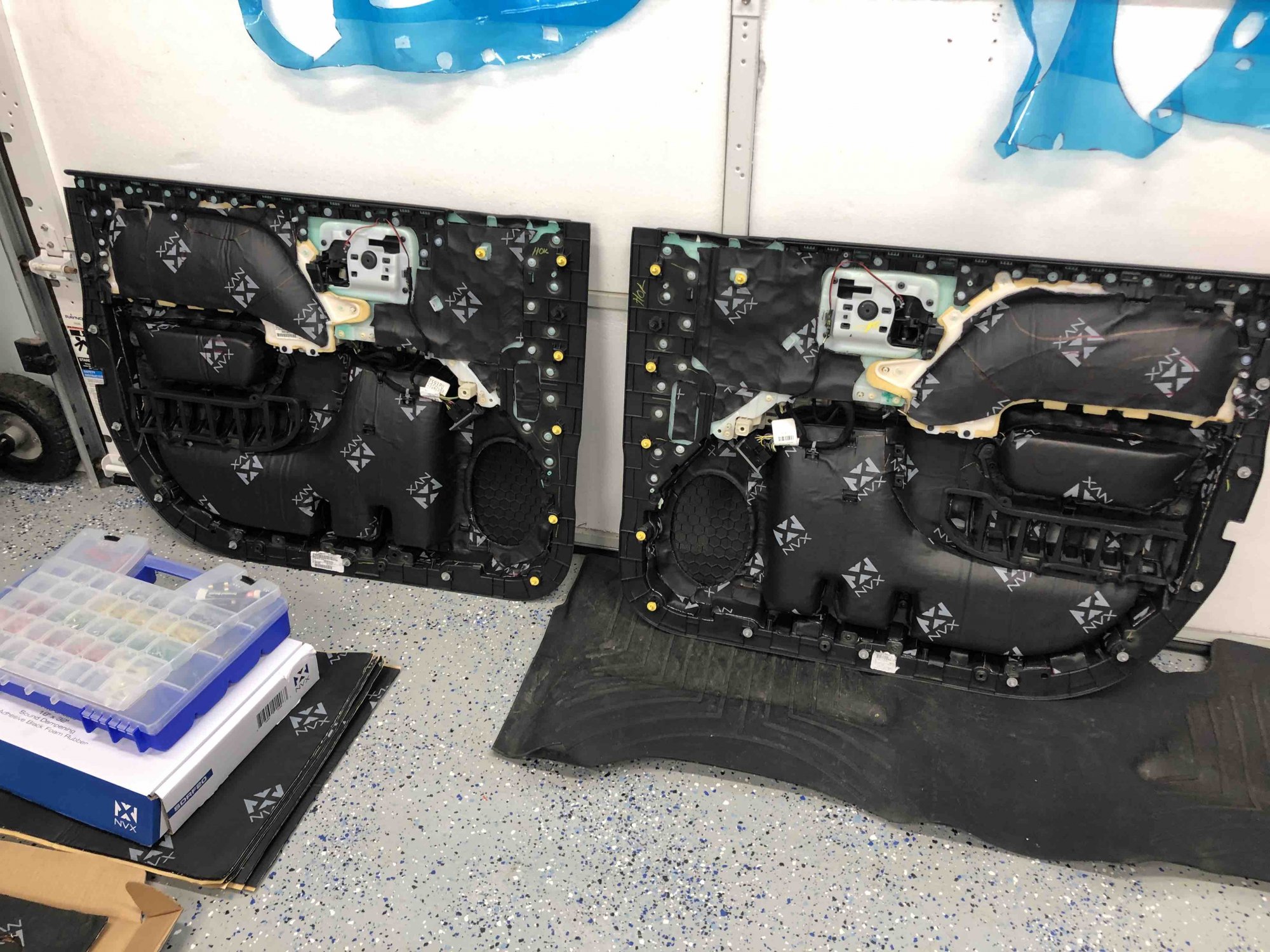

Doors got 3 layers of sound (inside skin, door, door panel)

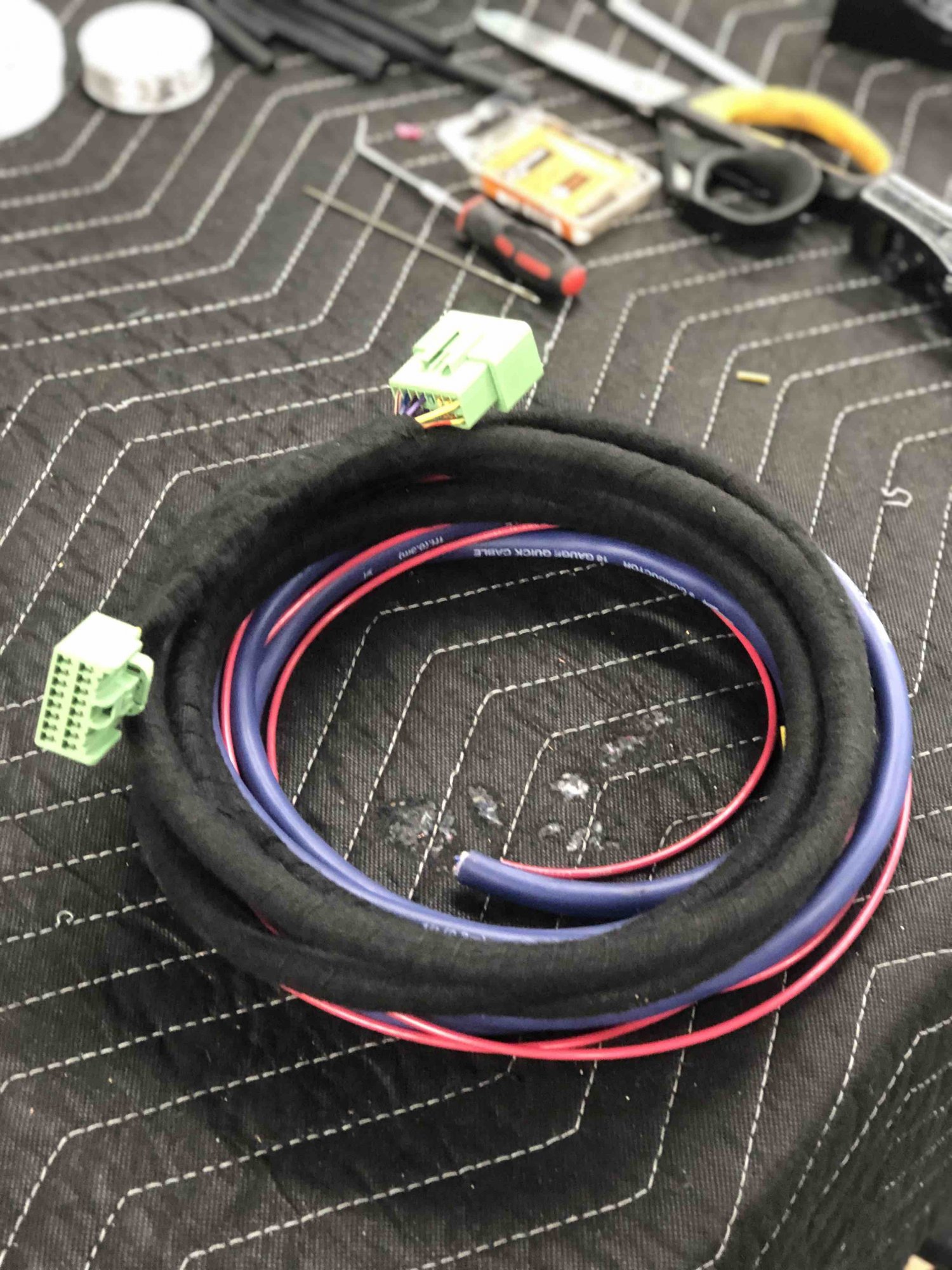

The t harness I made also connects the stock speaker wires running to the doors back in ( im wondering if this is causing noise as well)
