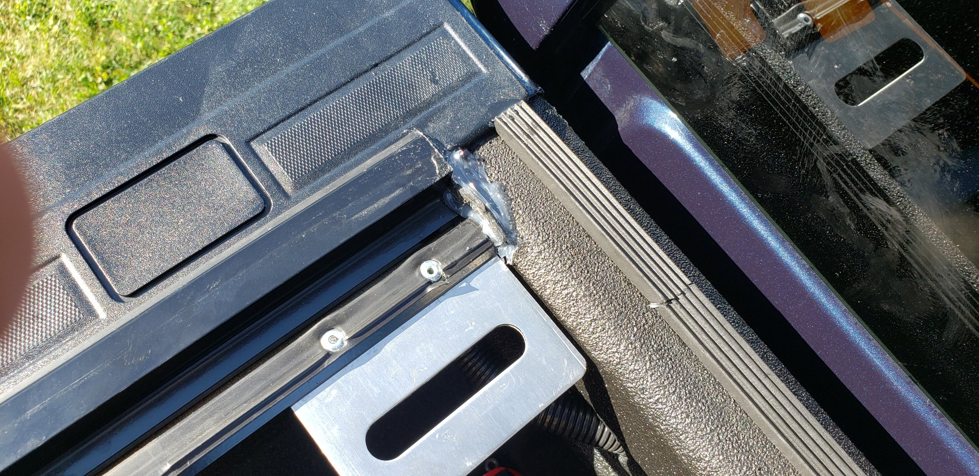

Did figure out finally how it was leaking.  Water is getting under the covered “tracks” the cover rides in and following it like a gutter and dumping straight into the bed up by the bulkhead.  From the best I can tell, there isn’t any way to fix or prevent this from leaking... just a bad design all together :(
Agreed that it's a poor design. It appears its so bad that GM is moving away from the BAK rebranded models in 2020.  They are not in the new accessories catalog as options anymore.
There is a way to fix it.  I took the rails off disassembled them I sealed up the bulkhead rail caps with some clear silicone. When I put it back together, I filled the gap between the rail and the bulkhead with a foam block and topped it with silicone. Now all of the water goes into the drain and out of the bed the way it should.
I also added a bead of silicone under the foam bulkhead seal as well. That stopped water from wicking thru the foam across the front of the cover
I finally got to really test her out this weekend. Drove 400 miles in the pouring rain from NC to PA. Got home, perfectly dry in the bed.
