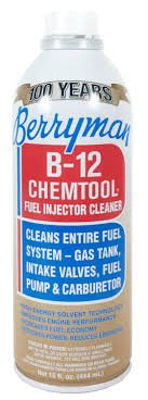

When i had my LS 6.0 engine tore down to a short block i cleaned the top of pistons to remove the carbon. I tried many things WD, Seafoam and more. The best stuff i used was Berryman B12. Let it sit for 10 minutes and the carbon just wiped off with ease. I wish they made a spray for the valves.
