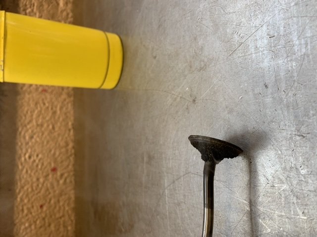

Before you spend your hard earned money on valve cleaners/carbon removers, consider what I tried today.

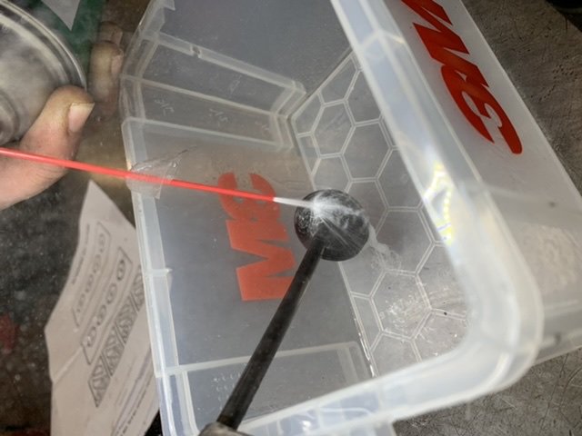

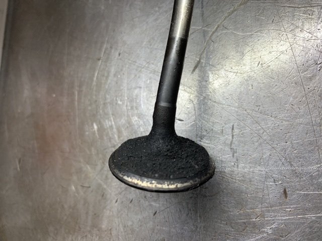

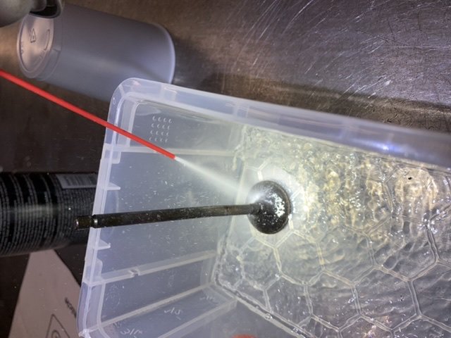

I sprayed an entire can of CRC directly on the valve. Then I let the valve soak in CRC intake and engine cleaner for four hours (agitating the valve back and forth every half hour). Then I took the valve out, heated it with a propane torch and let the heat sink in. Then I placed the valve back in the solution for another hour. I finally took that valve out for one more direct spray.
Very little carbon came off that valve. Direct spraying of two cans of CRC. A four hour soak. Heating of the valve face. Almost nothing was removed. Don’t waste your time...walnut blast these things if you want results.
Even worse than having no cleaning effect it actually looks like the solution has bent the valve [emoji1787]
