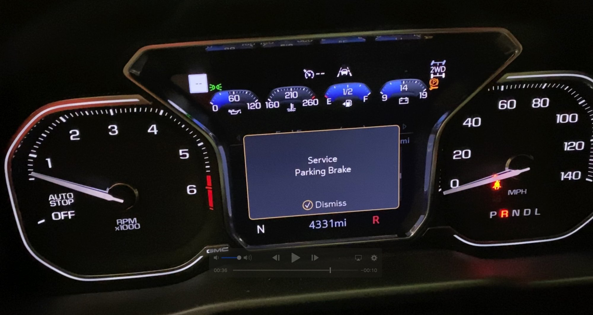

I had a very strange issue today on my 2019 AT4.  I came out to leave for the day, and I was met with a "service parking brake" message and a corresponding warning light on the dash.  The trouble is that the parking brake is on and will not release, so the truck is stuck in my garage.  It will not move forward or backwards with the throttle unless you really hammer it.  Has anyone ever experienced anything like this?
1928025950_Screenshot2019-12-1323_16_14.thumb.jpg.818ed5c0ec02e5d95c45ce67298134b0.jpg
Just to update - disconnecting the battery for 30 minutes cleared the error, and now the parking brake will release.
