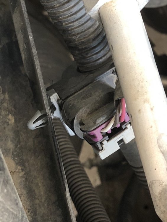

So I looked on the battery.  I didn't see anything right off of the negative terminal.  But I did see something that was on the cable that goes to the negative terminal.  Is that the same thing?
Yep, that's it.
On 12/26/2019 at 9:01 PM, swathdiver said:
Yep, that's it.
Cool!! Thank you very much for your help. I greatly appreciate it.
