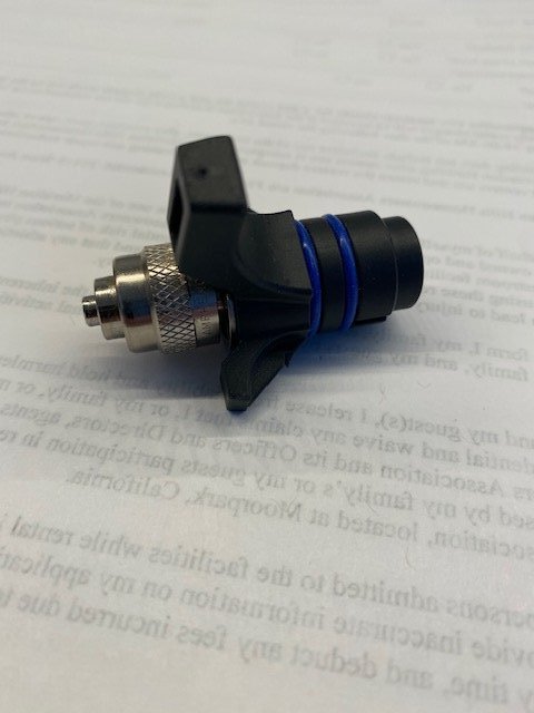

the issue right now with the HD cameras that we are unable to locate the end connectors. I’ve had several emails back and fourth and have located the the part number but they are only made to order parts. Here’s info I got for connector ends for a guy that pulled them out.
 P/N 031-6802

Thank you.  Just want to make sure I am clear on your answer regrading the cameras.  Are you saying any wired camera will work if you can find the correct end connectors?  Otherwise you have to buy the one from GM??
Correct. Any 1080 camera would work. The cameras gm is using are nothing special. I’ve spoke with a few camera companies that are currently working on addressing an aftermarket option. The issue is gm was on top of the issue and designed a proprietary connector with amohenol and are difficult to get. I’ve contacted a few distributors and am still waiting on a response back. Made to order part. I also refuse to spend $400 on a $25 camera that doesn’t have IR ability. Here’s a picture of connector and link for some more reading
Does anyone know how to open this plug to remove and repair the connector?  I have removed the clip but can't unscrew it or pull it out.  Seems like the common thought is to chuck it and use a new connector?
