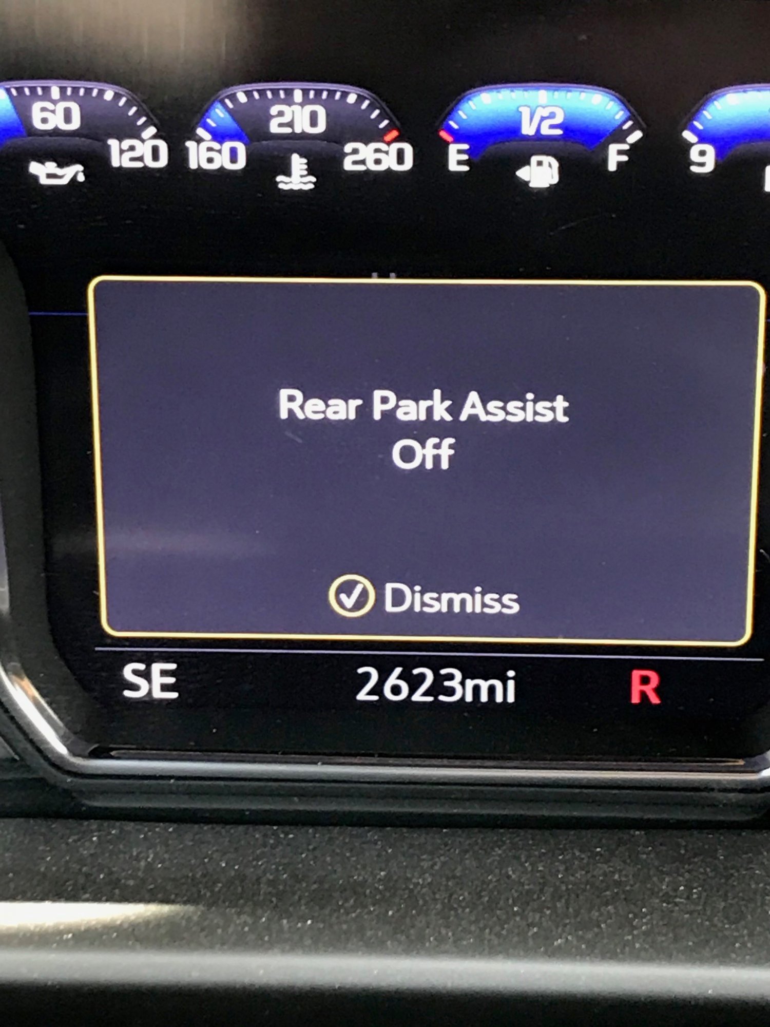

On 4/12/2021 at 6:16 AM, Paul Bergeron said:
My 2021 GMC 2500hd is doing the same thing.  Rear park assist works sometimes.
Paul
Looking for answers as well, I have same message as you. Vehicle is 2021 Sierra 1500 Denali. Brand new. Has about 200 miles on it, has done this since I purchased it. Vehicle is completely clean, no debris, no water, so soap. Works once in a great while, but this "Rear Park Assist Off" pops up in the display almost every time I drive the vehicle, from seconds after starting it.
The only time I receive this dic message is when I have a trailer plugged into the 7 way.
Any chance this 7 way could be damaged? I highly doubt it, but could the port be dirty and then get moisture in it turning to mud and making a resistance, making the dic think there is something plugged into it?
I have the trailer camera ports above the 7way. I think some trucks have a 4 way flat instead. Could that be causing issues?

But beyond that, you've never seen the "rear park assist off" message pop up at all, not a single time other than trailering? (identical to Paul Bergeron's image above). I ask because I was digging through the manual last night wondering if by chance maybe it pops up when you go above the 5mph limit or drive forward or something to deactivate it. But sounds like it shouldn't even be popping up then judging by your wording....

Yes - they ran real-time diagnostics on it and reproduced it a handful of times. The rear bumper sensors were “detecting” objects behind the vehicle. Turns out there was a TSB on the small circle round pieces that the parking sensors are mounted inside of being wrong / bad. They replaced all of those and it fixed the problem.
