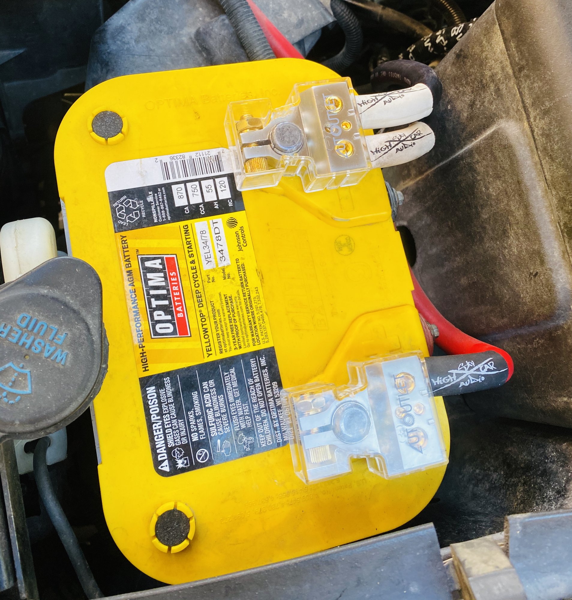

I have a 99 Silverado 4.8L 4x4; I have the check engine light on (currently). However, I don’t feel anything wrong with the truck. No rough idel or acting weird. I have already replaced; fuel pump, fuel filter, spark plugs, wires, #4 injector and air filter. All Acdelco brand, yet this light is still on.
One thing I did notice different, my battery voltage  drops. Which is weird since I have bigger alternator then 105 amp, optima battery, and big 3 wire upgrade.

I have a new Optima Yellow top battery, and upgraded alternator from 105 to the bigger one the 05+ models have can’t remember if it was 145. It has a Big 3 Upgrade. Yet voltage still drops, when idel. Also cleaned all the grounds the truck has.

Already cleaned off all grounds and added grease. Terminals to battery are clean as well. One of the grounds comes from frame; which was sanded and threaded with a bolt. Second ground comes off the alternator bracket. Power comes straight from alternator. The factory connections are still there on side post.
What about the ground thats near the bottom of the block on the left hand side? It's the main engine to battery ground. I just found one recently on a friends 1500HD that was finger tight and causing low voltage issues. A simple voltage drop test showed about 1.5V being lost between the engine and battery. And yes, this is the ground from for the alternator as well, since it goes through the bracket to the engine block and then out to the battery.
