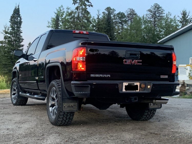

I am running a 33x12.5R20 on stock +27mm Snowflake wheels which is a really fat boot for these trucks and that wheel offset. Little rub on sway bar and UCA but unnoticeable during daily driving unless you're cranking full lock to stall park. My friend runs a 305/55R20 on a Silverado with no rub. As long as you stay under 34" you can basically go as wide as you want as my tires are pretty much a 315 section width. Im on an RC level, not lift shocks but if you can get a true 2.5" from them you can fit everything I can.
