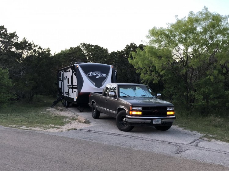

I know Im about to get blasted here but in total transparency here it is:
My 91 with its cab configuration and engine option is 5500 with 3.08s, 6500 with 3.42s and 7500 with 3.73s.  I'm way under my weights in payload, axle weight ratings and GCWR.  I have upgraded the engine to a more powerful L31 vortec motor compared to the old 210hp LO5 and have exhaust mods.  I know I'm over max trailer weight but my logic (however flawed it may be) is that from a safety standpoint, my truck is no different than a 3.73 geared truck (same suspension, weight, brakes etc).  I have upgraded the tires and shocks and have a really good WDH.  That being said, I only use the truck to pull within about 100 miles or less and even then, I have to carefully plan.  I keep the trailer as close to empty as I can and have to make sure I avoid situations where I might have to reverse up hill.  Its not ideal, but the forward gearing of the NV3500, it does fairly well and I borrow other trucks when I have to go farther than 100 miles.
From the beginning this was temporary.  I bought my trailer first knowing I would match a truck to it one day.  I've been wanting a K2xx truck for a while now but needed to get some things in order first.  Now im ready and on the hunt.
