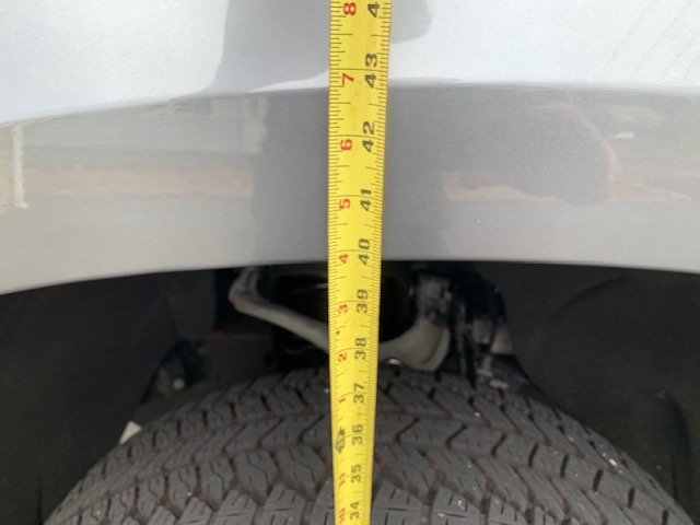

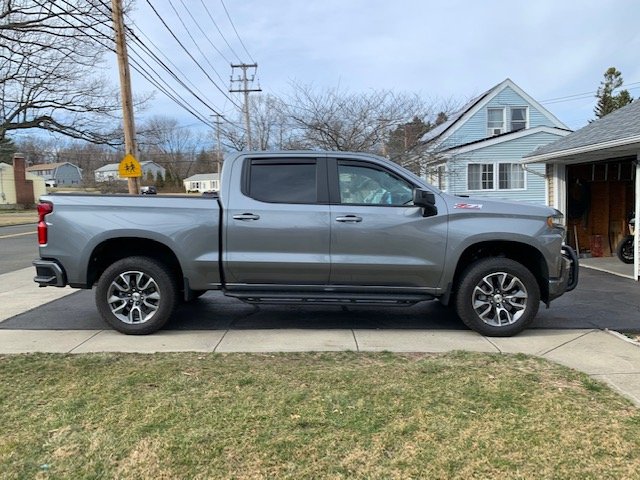

Rough Country  2 inch leveling shock review. I have to say it rides great . First thing I noticed was the extra 1/2 after the removal of the Motofab 1.5 lower spacer. The ride is just a tad better then the factory shock. Jump on the highway up to 85 felt great. Went over some low grassy hill in the tractor supply parking lot at some speed. Soaked them right up. I would like the have them in the rear to to get a full review on them. But don't plan on it.   I did measure the the Rough Country Top plate to center hub bottom. 23 1/2 inch's. The factory measures 22.0 inch's. So that's 1 1\2. And I mentioned the spring on the rough country is smaller in dia.  Fender's measure about 40 inch's . I know the truck was 38 in the front stock. Still have my 1.25 block in the rear. Still have a slight rake. But if your looking for something close to factory good price. You will like the ride. Now that I have the factory struts out. When the time come 3 or 4 years from now . I will buy a spring compressor. Maybe try the Eibach or Billstin. But I'm good for now. Best I don't have to worries about those lower spacers. At least RC had the common sense to remove them from there product line. Best of luck. Ps parked next to a trail boss at the store. Looked just as high.
Nice! Yeah my TB looks similar height to yours, I gained around an inch and a half, I could go a little higher in the front but I like a tiny bit of rake. Glad you’re happy with the RC set up it just wasn’t for me, but we can agree these are both much better options than the lower spacers! There’s a reason they were only like 20 bucks haha
