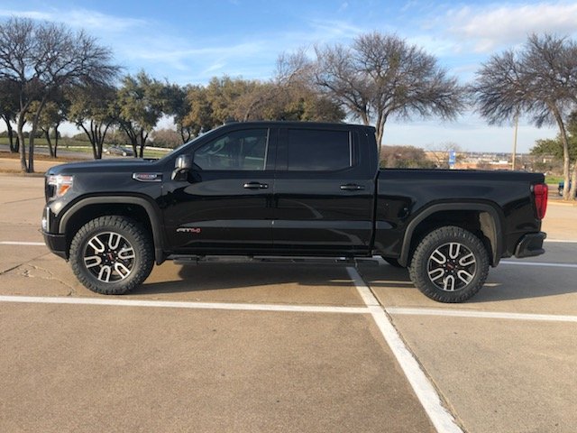

I have the 35x11.50 on my AT4 without lift although I will add a 1" up front in the future just for looks. Yes they are heavier than stock but they ride very smooth for what they are.

barely and just for a split second if I am at full lock turning into an incline
