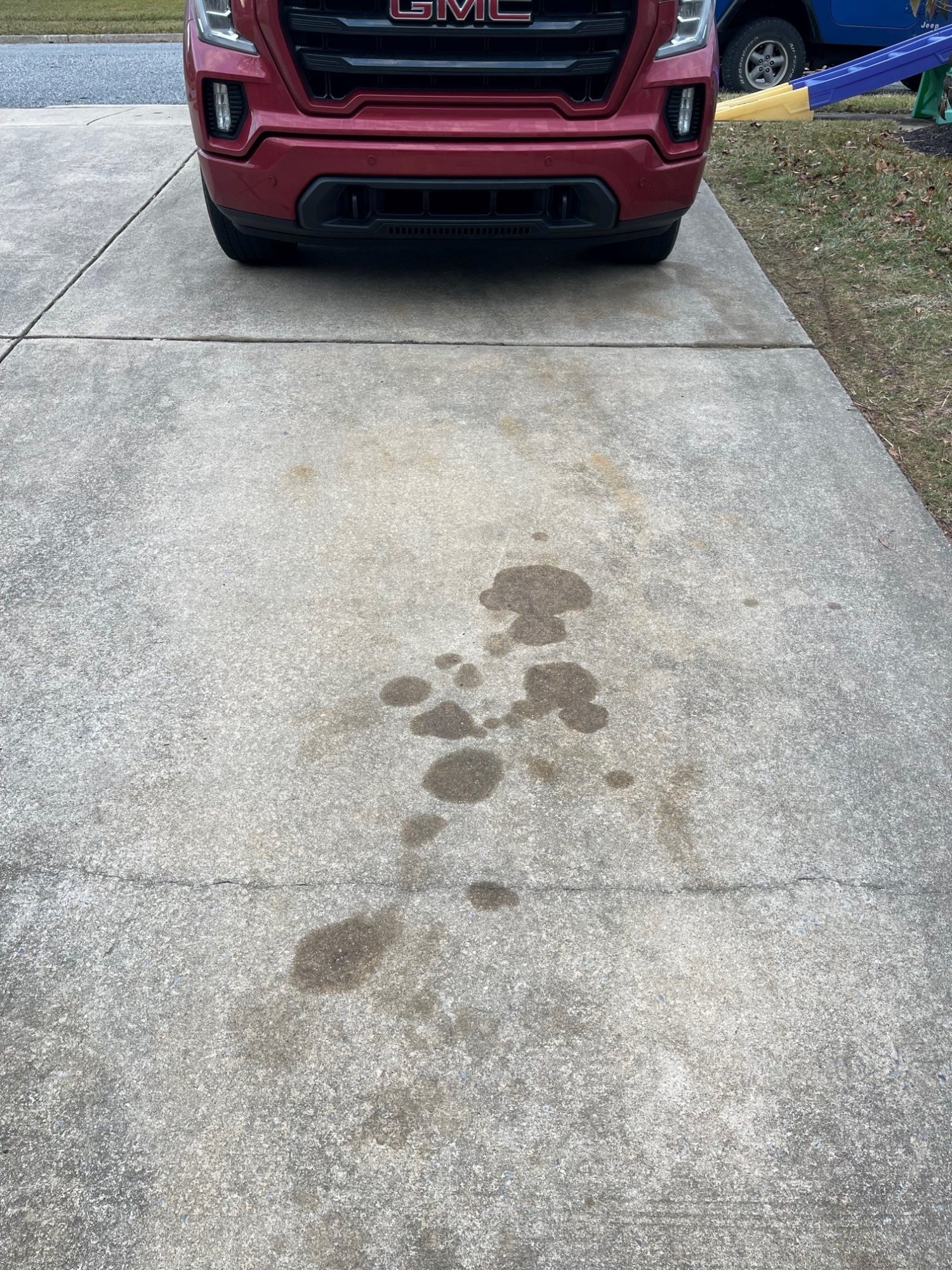

I picked up this 2.7 2020 GMC in mid-December. Notice that it has several oil spots under it every morning. I have about 35k on it. Shifts badly when decelerating around 20-15 mph. Spots seem to be under the transmission rather than the engine. Is this what I'm in for with this truck?
