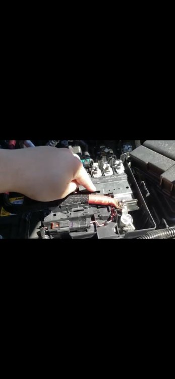

where do you have your power wire connected? I don’t have mine connected directly to the main positive terminal, but rather To a lug on the block on top of the battery. In the LLJ Customs video for their Trail Boss amp install they did the same, and had no issue. I’m thinking of going directly to the positive terminal to see if that helps. It’s almost like I’m either starving for power or getting too much.
I have mine connected to the terminal you don’t want to tap into the block. Yeah I meant the loc.
47 minutes ago, SummitBoss said:
I have it attached like the picture. No bueno?
Yeah that’s where I have mine attached
