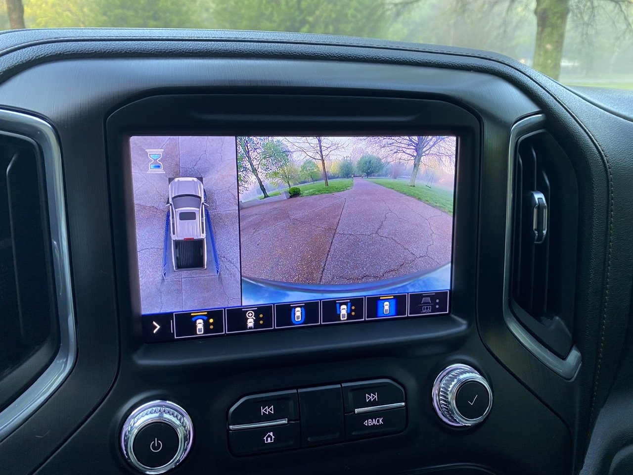

So theelementalcashew and I just swapped.  I have a 2020 AT4, fully loaded, and he has the exact same truck but 2019.  Mine came with tow mirrors but I prefer the smaller ones.  Everything works BUT the cameras are gonna need recalibration (see photo from mine, now with smaller mirrors).  We lost the parking lines when in reverse and there’s a weird slice on my view where the camera must be programmed for a different angle.  My dealer thinks they can reprogram and plans to try next Tuesday.  Only other thing is the rear facing lights on the tow mirrors don’t work on his truck but we knew that going in.

To add onto what TNAT4 said, the turn signals/running lights are not operable on my truck either. The task lights and puddle lamps are swapped in the wiring, so when I unlock my truck in the dark the task lights come on instead. As in his situation, I lost front and rear parking lines and my side cameras are slightly skewed. And the rear facing LEDs don’t work.
What does work: cameras, power adjust, power fold, heat, blind zone detection. Hopefully most of the other things will be functional once I figure out how to swap wires in the harness, or get my hands on the part number for the correct door harness.
