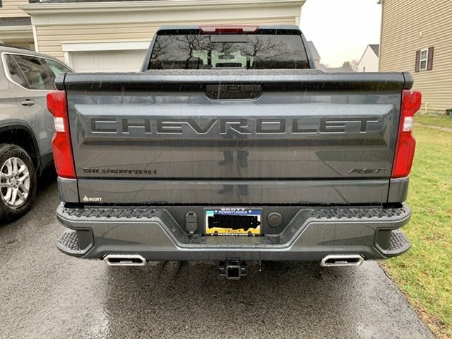

I was wondering the same thing, all my emblems/lettering are black except the Z71 emblems and the chrome around the black bowtie (my chrome exhaust tips don’t quite fit either but may end up doing Borla kit with black chrome tips down the road). I’m considering black vinyl, my brother is GM autobody tech and said the emblems are a lot of work to remove. I haven’t found any yet, will post if I move forward with it.

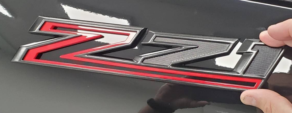

Like this?
Removed the logo, trimmed off the tabs in the back holding the red part in. Removed the red part, spray-painted the chrome with a semi gloss black (after some light sanding), then hot glued it back together.

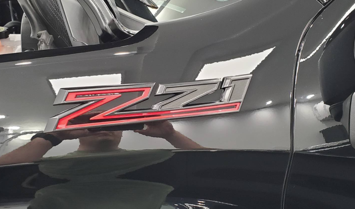

Here's what it looks like against the truck paint:
Full disclosure, my buddy who is doing PPF and ceramic coating on my truck did it.

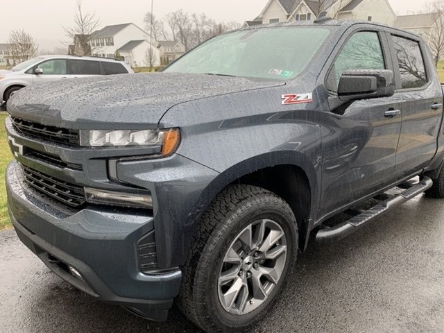

I had all my emblems replaced with black, but there was no Z71 as you discovered, and corrected for yourself!
You can do the same thing with the RST tailgate emblem. Buy a black one, cut (or Dremel with a bur) the heat melt pips on the rear of the chrome one, remove the red RS and 3M tape or glue it on the black one.

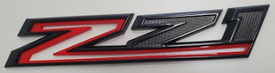

He custom cut the 3M adhesive, which was a bunch of work (all told (including prep, paint, etc.), he said he spent between 5 and 6 hours on the two emblems).
Here is the 3M:
Here is the finished, mounted product:
