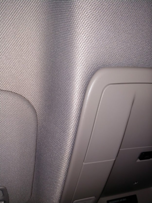

I'd like to add the Homelink as well, and based on this thread, I'd probably order the entire assembly as in the first link.  How do I know what color is right for my interior?  I have the Jet Black interior (RPO code HOU) with the light color on the roof and pillars.  I would call the roof color "puddy", but I've seen the assembly available in colors called "gray", "light ash/gray" and "tan."  Does anyone know which console color would be right for my interior?
Post a pick of your interior one of the GM colors is called shale.
This is mu headliner...
Thanks Waffle.  I ordered the gray and it arrived today.  I haven't installed it yet, but it looks like an exact match.
