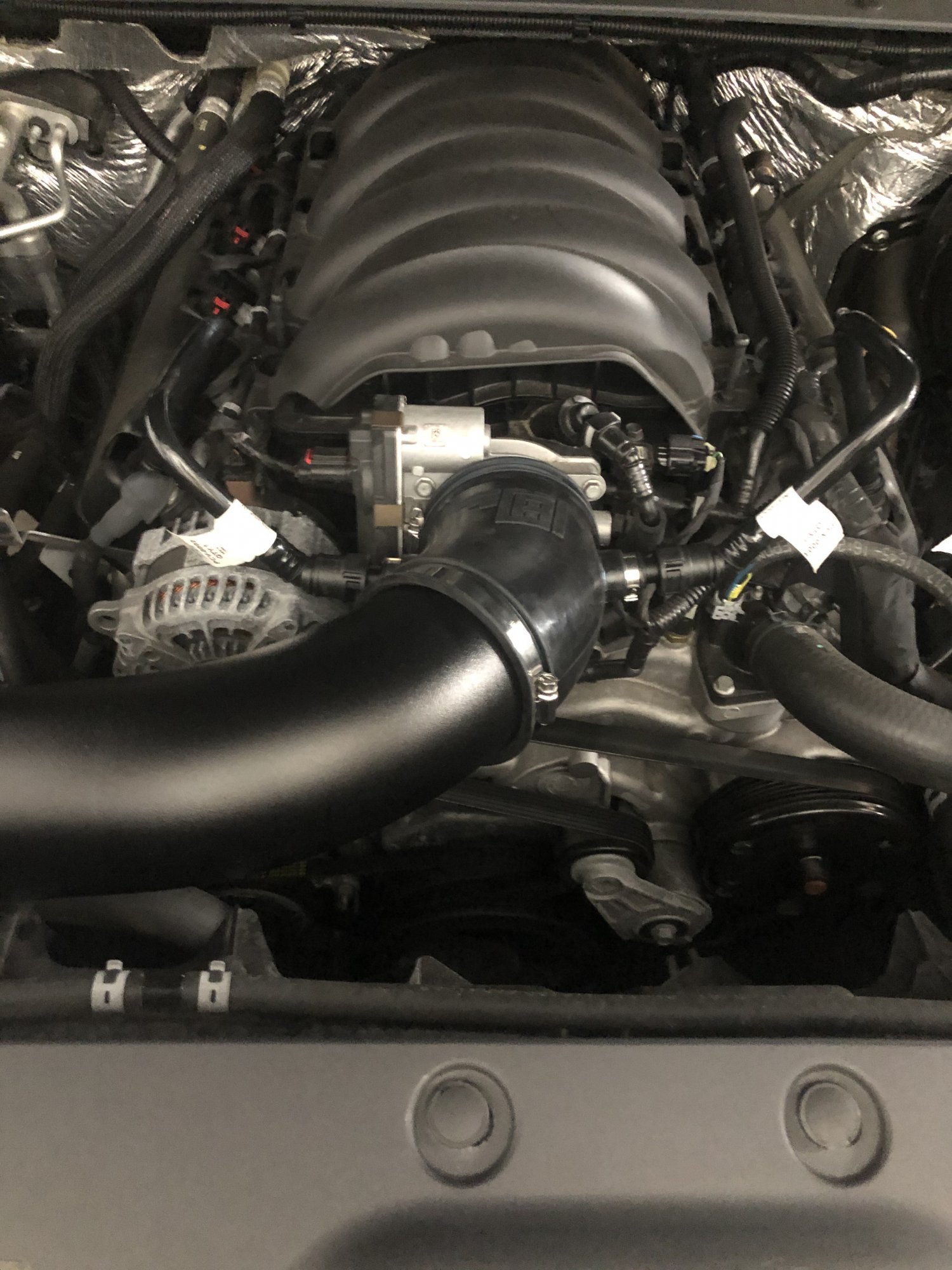

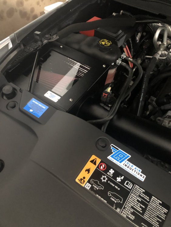

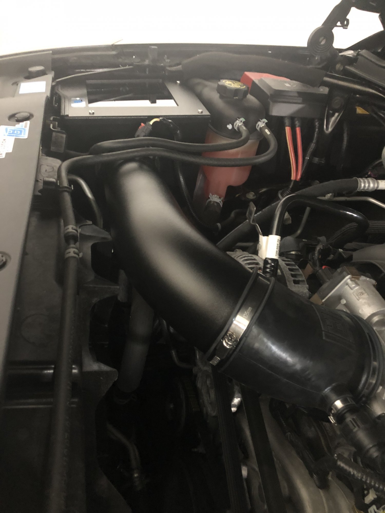

I ordered the Cold Air Induction CAI and the GMC Borla Cat-back (Touring w/flapper valve) Exhaust. Tuning will follow, just don't know which tuner as of yet (Diablew, Blackbear, etc)
