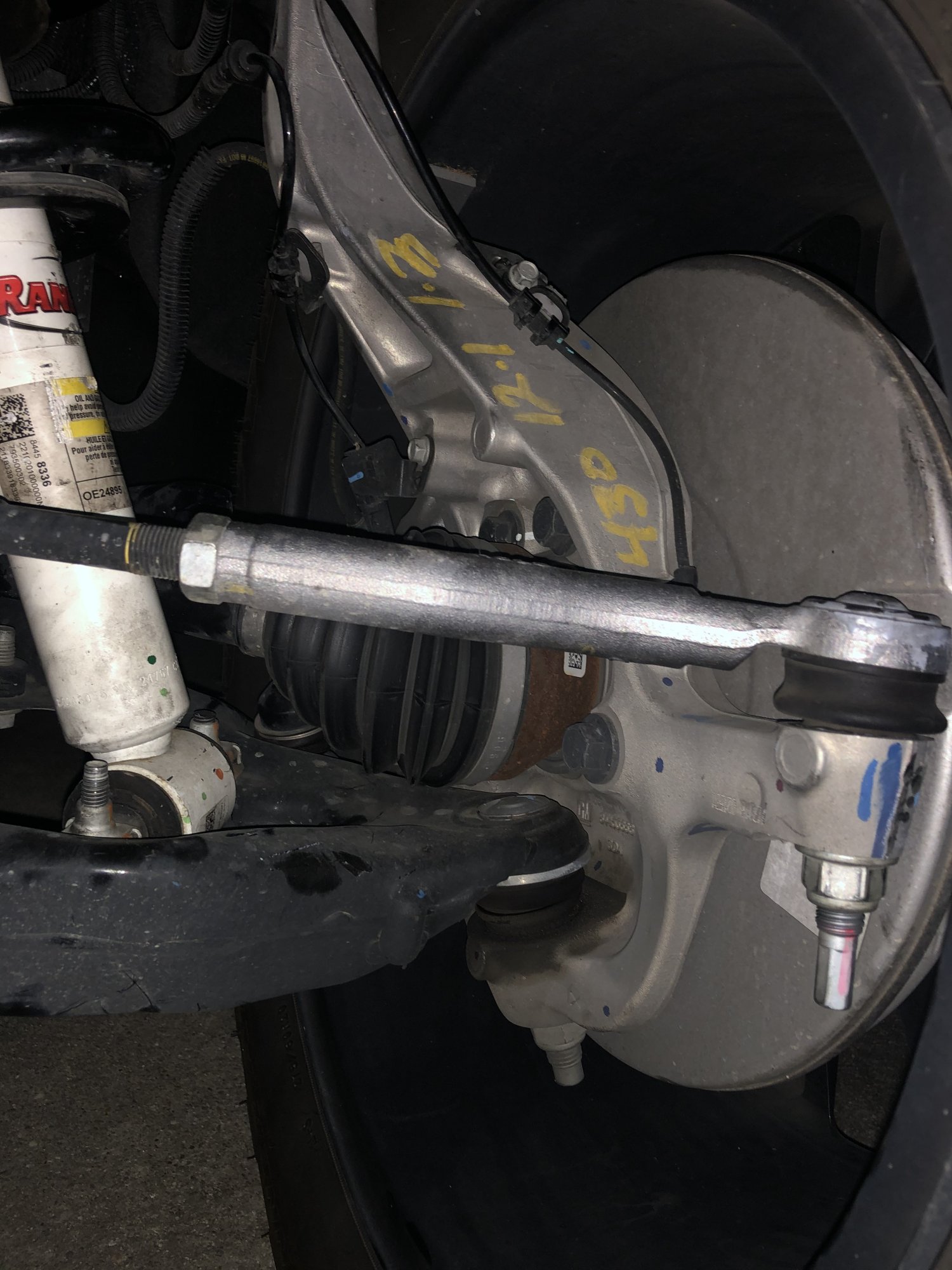

Installed the 2 inch top strut spacer from Zone Off-road. The photo is after the install, did not get any before. The truck originally had just under a 1.5 inch of factory rake. However the measurements before install were as listed
Right - front  38 4/8th
Left - front 38 5/8th
After install measurements are 39.75 up front.
Not exactly a true 2 inches but the truck is still a tad more then a quarter inch high in the front but not noticeable to the naked eye in my opinion. The CV boot is also clear of the bottom of the strut. I will try and take additional photos of the upper ball joint and the cv angles when I can.

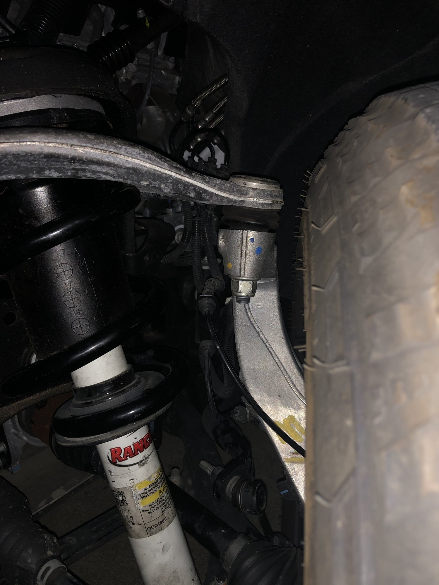

Updated photos of ball joint angle and clearance between side wall of tire and upper ball joint, which is a good 1/2"
