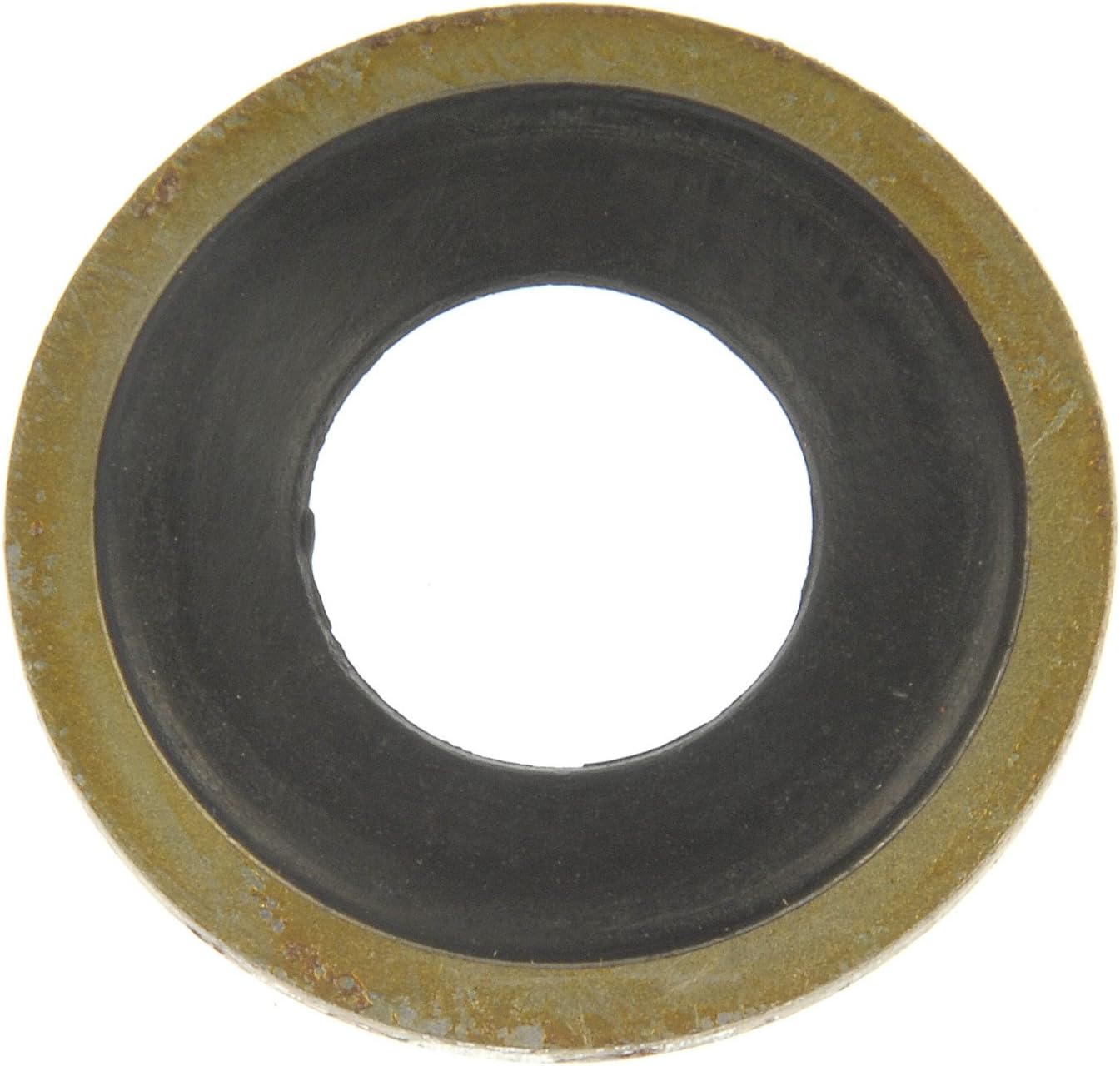

M12 too small, m14 too big. Ended up removing the crush washer on the "stock" pan bolt (pretty sure that was my issue) and replaced with the m14 synthetic washer. Have cardboard under it, but I'll be able to tell if it's leaking just by looking around it. The surface on the oil pan looked good. Hopefully this fixes it. The plug itself is in good condition so I won't replace it.

Thanks, but I think this washer should work just fine, went out and checked and it looks good so far. I'll take it for a spin over lunch and check it again.
