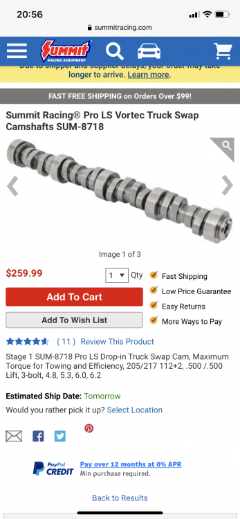

Been looking real hard at this cam here curious if anyone is running it
That cam would be good. Going bigger is going to shift the powerband further up and likely not where you want it.
With a good tune it's probably another ~20-30hp/tq over what you have now. Your mileage isn't really high at all, I'd have no problems swapping in a camshaft at this mileage.
I'd only touch what you have to when changing it. New front cover gaskets, cam retaining plate, lifters and head gaskets. If you have good oil pressure now, don't even remove the pump. High volume pumps aren't really ever needed for 99% of people.
