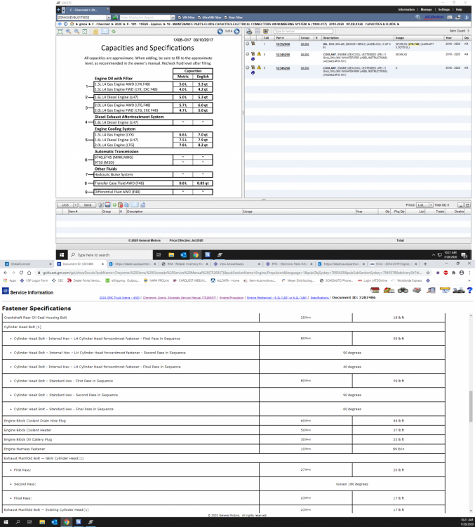

Oh yeah, and ready to go back up with it.  Had a stuck lifter on #7 cylinder , I guess this AFM systm is hard on them.  I almost started o do a complete DOD delete on it.  It is my grandson's truck he  JUST bought  and had this running problem and a tune didn't fix it.  He  is in a rush for it,  I got a hold of the dealer he bought it at and they were helpful and gave me the head bolt torgue specs.  They were
1.  59 ft lb  then 90degree  and 60degree final torque.     It has been an experience not like the older cars .
call up your chevy dealer they'll tell you.   I like to do a stage torque pass in 3rds, before hitting the final torque spec. then do the final degree torque  pass

Sorry it's grabbing both of my screens ignore the top portion
