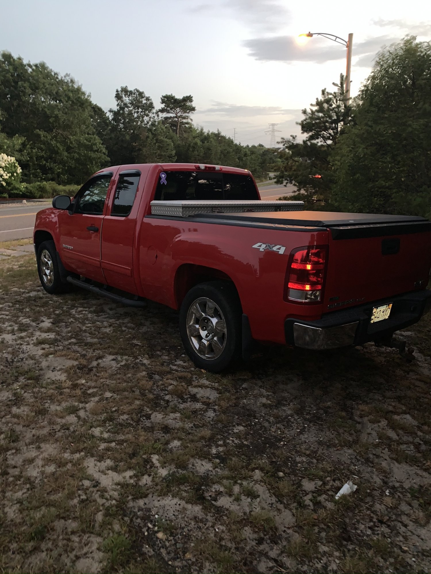

I own a 2011 Sierra 1500 SLE extended cab with the 5.3l flex fuel engine w/ 200k miles.  I've had it since new and love the truck but the engine is on it's way out.(loud ticking and fouling plugs faster than I can replace them).  I'm thinking about replacing the engine myself but I'm having a tough time finding a replacement. Can anyone recommend a place to search? Seems like every time I find one it's the wrong VIN# to match or if I find one it's $3000+. Not looking to break the bank because with my luck, once I get this done the tranny will go on me! Any Suggestions would be greatly appreciated
