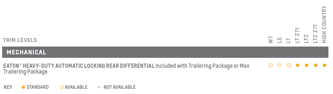

G80 (Eaton Locker) is an option and not standard on all truck trim levels. The following is from a 2015 Silverado sales brochure. It states which models it is standard or optional on as well as being included in both trailering packages.
