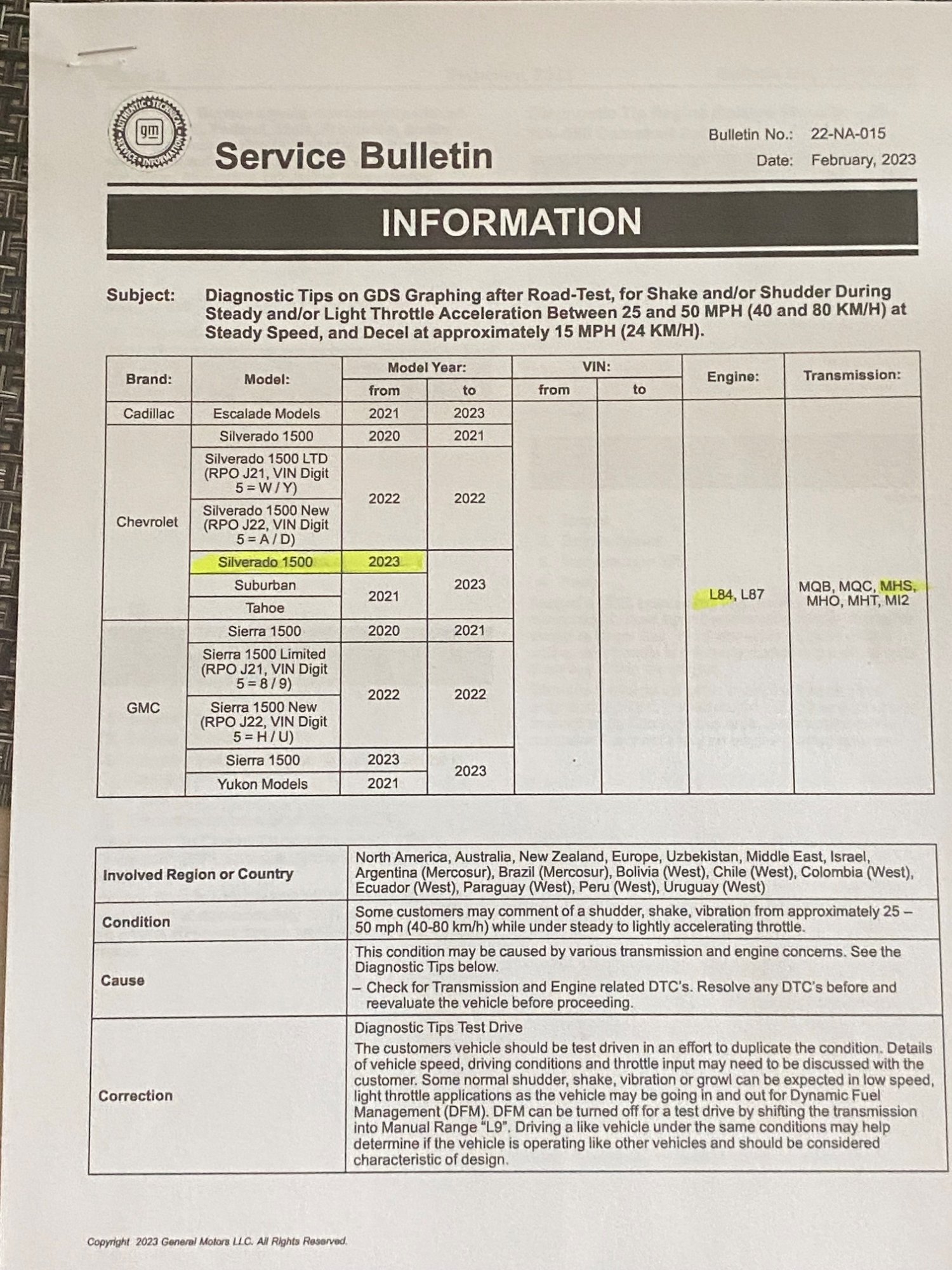

GMC and other automotive manufacturers often release Technical Service Bulletins for common issues. Check with your dealer to see if any TSBs related to your problem exist and if they have been applied. freechat

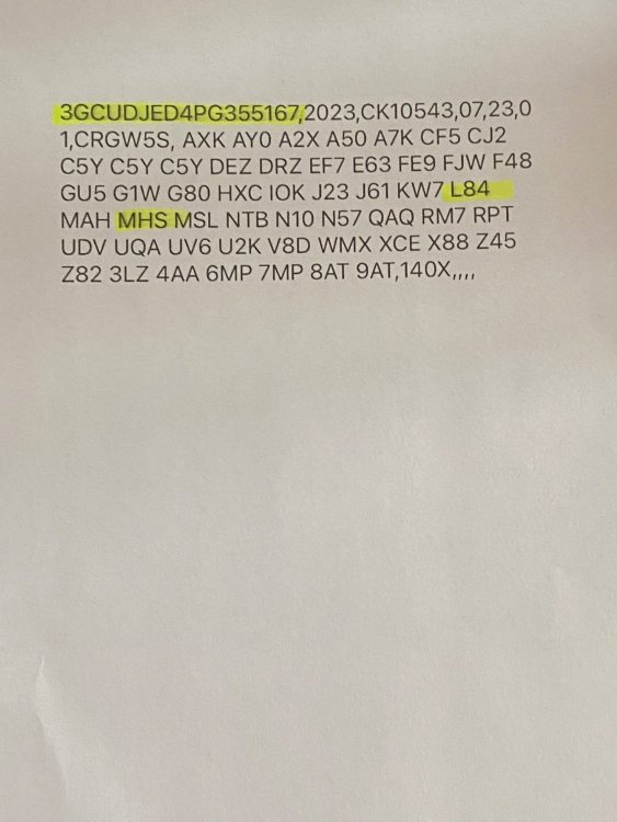

On 9/21/2020 at 4:47 PM, Douglas L Self said:
I have a 2020 GMC Sierra 1500 5.3 with less than 12 K miles I have had it in for the problem 3 times. I am told there is nothing that can be done to correct it. Here is the problem,  at any speed (especially highway speeds) a vibration occurs frequently, it only last a few seconds but a mile or so down the road it will happen again. This happens on flat roads hilly roads and can really be felt on smooth roads. The last time I had it in the service department they said it is happening when the engine changes from 8 to 4 cylinders and back to 8 cylinders and that there is nothing that can be done to correct it. It is hard for me to believe that GM has built a vehicle with a very annoying problem and it can’t be corrected. I am thinking seriously about putting signs on the truck that says (DON'T BUY GMC TRUCKS THEY CAN'T FIX PROBLEMS WITH THEIR MOTORS). I paid way to much for this truck to have to have to go down the road with it vibrating and shaking, very annoying!! Anyone else have this problem and does anyone have a suggestion how to correct it?
I have the same problem and it’s been to 1 alignment shops, 2 separate Chevrolet Dealerships and had the wheels balanced!
it vibrates and shakes driving down the highway or any road! It Sucks!
Mine is a 2023 Chevrolet Silverado 1500 5.3 liter w/ 10 Speed Auto, High Country 4x4 SB with 22” wheels. That engine sucks, the 6.2 liter you hear and feel it every time you touch the accelerator!
the 5.3liter is lost in all the auto cylinder deactivation, 10 Speed Automatic Trans with zero feel or feedback from the 5.3, it’s a horrible experience period! GM buy back this crap!
