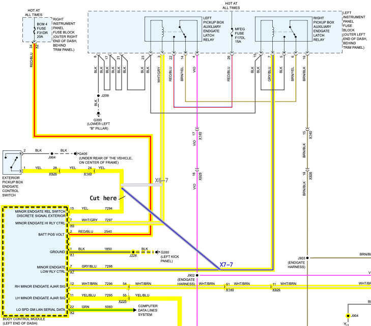

On 5/10/2022 at 3:51 PM, Sharpie said:
I just did a multi-pro swap for my 22 Silverado and it was relatively easy.  Luckily all of the wiring and relays were there for the minor gate.  For starters I cut the ground wire to the mid gate switch.  I needed to get 12V to this.  (I know I am talking ground and 12V, but stay with me here...)  At the Chassis side of the tailgate harness there is 12V Battery at Pin 1.  this was ran for trucks with the power up option.  My truck had the fuse and ckt already.  So I cut the lead out of the connector and ran a new wire up through the tailgate following the factor harness and connected it to the ground side of the pin on the minor gate switch.  The other end of the switch is the yellow lead that goes back to the BCM to signal the button was pressed.  Again I happen to have the minor gate relays and wiring on my standard gate LTZ, so I don't know what other trims it was also there. I needed to use this new 12V ckt I made to go direct to the two relays top drop the minor gate.  At the BCM I cut the Yellow switch wire (Pin X6-15) and connected it to relay outputs White/Gray (Pin X6-7) and Gray/Blue (Pin X7-7).  From the BCM this relay output was power to ground.  So by starting my switch at the 12V+ I just created a new ckt though the switch to the relays and down to GND.  I did pull the 30A endgate fuse while I was doing all this.  It all works!  The only downside is when the vehicle is locked, this ckt is still powered and will open upon press. I have the factory up fitter switches too, so I think I will use one of them as a disable possibly.  Should be really easy as the BCM is right below the upfitter switches.  The multipro I got was the same color truck but a GMC.  I still need to swap the emblems.  Waiting on a good sunny warm day to make that chore a little easier.
My question is do you splice into the X6-7 and X7-7 wires or do you cut and connect?  If you cut is the connection on the BCM side or the Aux Endgate Latch Relay?  Thanks in advance for the help.

@b marks did you end up trying that?  And did it work?  I’m in the same boat.  Bought the multipro tailgate for a heck of a deal and trying to make it work. Locking works, and so does video, remote dropping tailgate works as well, it’s just the smaller portion of the tailgate doesn’t drop at all.  Seems like my harness is definitely missing that pin

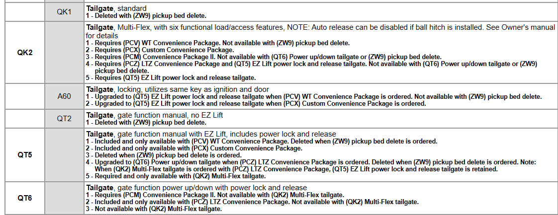

Is there an auto up function for the HDs? Doesn't seem to work on mine if so (or maybe I just dont know how to use it).
Standard gate, yes, multipro, no.
The power up/down option (QT6) is only available on silverado.
Both HD's can get EZ lift, which is different than power up/down.
2023 2500 Silverado tailgate options
2023 2500 Sierra tailgate options
