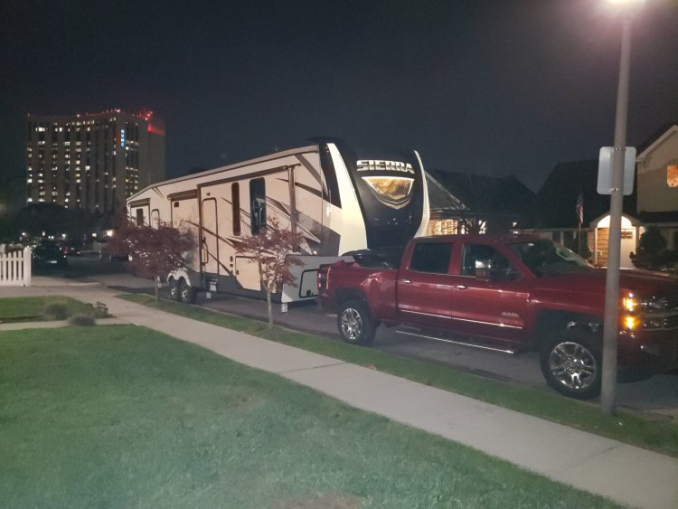

Got the new trailer.  At 14k lbs its time to upgrade truck.  Brought the camper home.  Flat drive she did ok, e85 dic read 7mpg at 60mph.  But once i hit the mountains mpg dropped as expected and she struggled.  From a dead stop going up incline didn't think she was gonna make it, on level ground she did it ok.  On 200 miles trip avg mpg was 5.5 on dic.  Not sure if 4:33 or 4:56 would help.  Gonna start shopping for a diesel.  Other than that i was really impressed how she handled it.  Airbags helped no squat.  Truck is a 15 hc with a tune, cai airbags with andersen ultimate hitch.
Nice 5er. Ours is 9400# dry and 11,500# GVWR, so perfect match for the 6.0L IMO. Do you think CAI was worth investment?
We too have the Andersen. Love it. I have been eyeballing the Reese Goosebox, but for now will stick with Andersen.
That Sierra is a big girl. You are wise to shop for a diesel, and should go 3500 if you weren't planning on it already.
No replacement for that near 1000 lb/ft of torque, though. That's a big trailer, a nice big trailer, a 3500 would handle that weight better, I would imagine.

Get a bigger truck.  You are approaching DRW territory with that trailer.  2x a year or not, your truck is way overloaded with that trailer.
